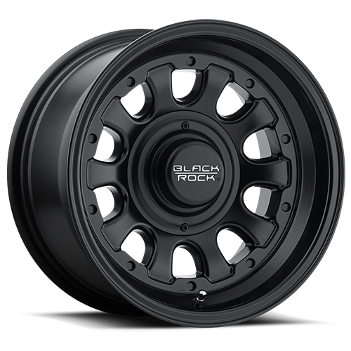

Mmm Black Rock 909-B. A pity they don't come in 16" though, because my next set of tyres will be 235/85R16.
