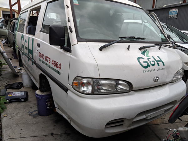

You know what else has 24mm torsion bars? A Hyundai H100 van. Like this 1998 one at the wreckers:

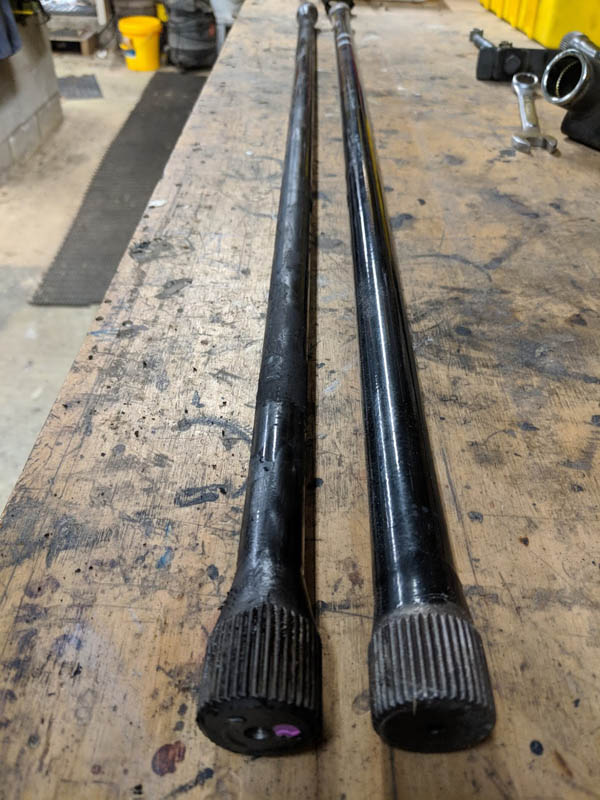

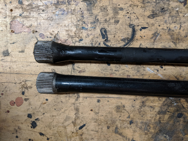

The H100 is basically an L300 underneath, and the torsion bars are a perfect match... and they only cost $40 from the local wreckers.
IMG_20180503_151859 copy.JPG (113.89 KiB) Viewed 21027 times
IMG_20180503_151909 copy.JPG (274.53 KiB) Viewed 21027 times
Hyundai part numbers were written on the bars. LH side = 5415043160, RH side = 5416043160.
Hyundai don't fit rubber boots to protect the splines, but it's easy to swap your boots from your old torsion bars to the Hyundai ones. It's about a 45 minute job to swap both bars, and another 15 minutes to set the suspension height.

I wouldn't trust a torsion bar from anyone but a reputable manufacturer- they're the sort of highly stressed component that can fail from one tiny flaw.
Hyundai part numbers were actually written on the bars, which was nice:
The H100 I got the bars out of was a 1998.
