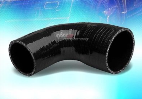

I used a 1.5" - 2" elbow at the turbo like this one :https://www.amazon.com/1-5-38mm-Silicon ... B015PZKIGA
...and made my own 2" inlet stub, because the old one was aimed the wrong way and I figured I might as well make the new one 2" to match the new plumbing.

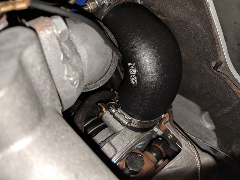

Pipework from behind and below, camera between torsion bar and exhaust pipe. Black silicone pipe is the 1.5"-2" 90 degree outlet reducer. Top left is the new 2" inlet manifold stub, which aims forwards and out about 30 degrees from vertical.

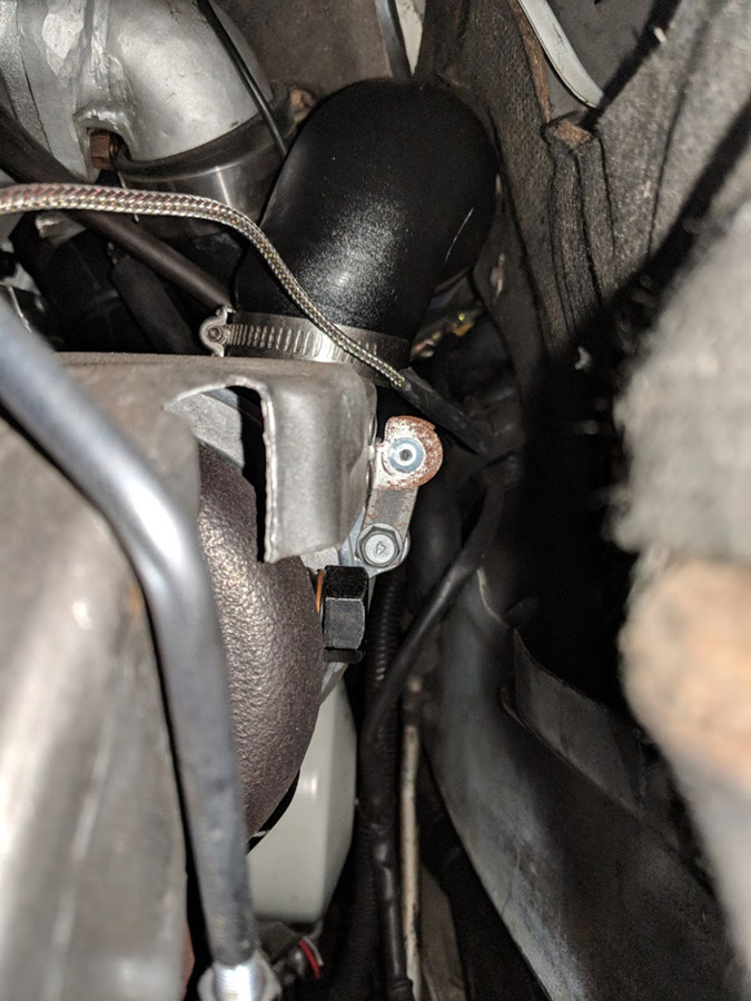

Turbo from below, camera just behind alternator, below oil filter. Turbo outlet reducer is black. Blue silicone sleeve over the 2" pipe going to the intercooler. Black silicone pipe with "redline" printed on it is the pipe coming from the intercooler to the inlet stub:

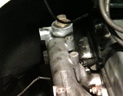

Pipework from behind and above, camera wedged between inlet manifold and engine cover. Outlet reducer is fairly obvious, and you can see how the inlet pipe tucks under the turbo outlet. Ugly weld on the inlet stub that's on the back where no-one will ever see it. Nice new turbo is shamefully rusty, might have to clean that up.

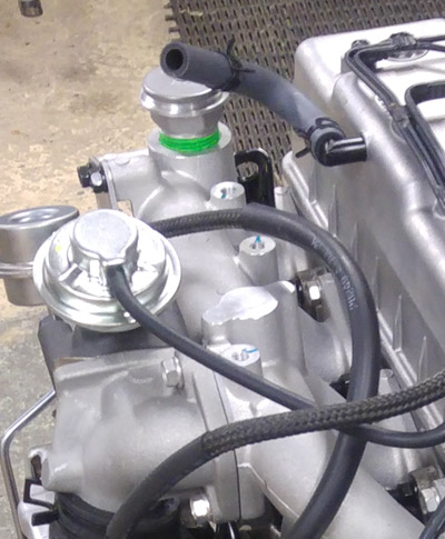

I'm also very interested in the BOV delete, if you could provide a pic of that that would be great, I was not aware that this engine had such a thing being a diesel? You pretty much don't want to drop the boost on diesel ever.
It's not really a BOV, more an overpressure relief valve for emergencies. I think it's there to prevent you from powering up a hill with a jammed-closed wastegate, feeding the engine 20psi of superheated intake air, which would hole a piston pretty quickly. It's certainly not there to protect the intake manifold (later engines run 25psi just fine- but they have variable injection timing and an intercooler so can cope with hot air). It doesn't prevent the turbo from overspeeding either- it's after the turbo, and venting air after the turbo makes it spin *faster*. It opens at about 12psi (unless it's old and tired, then it opens earlier) and makes a farting noise. It has to be modified or deleted if you want more boost.
It's the green-threaded thing in the first picture, replaced with the brass thing in the second:
