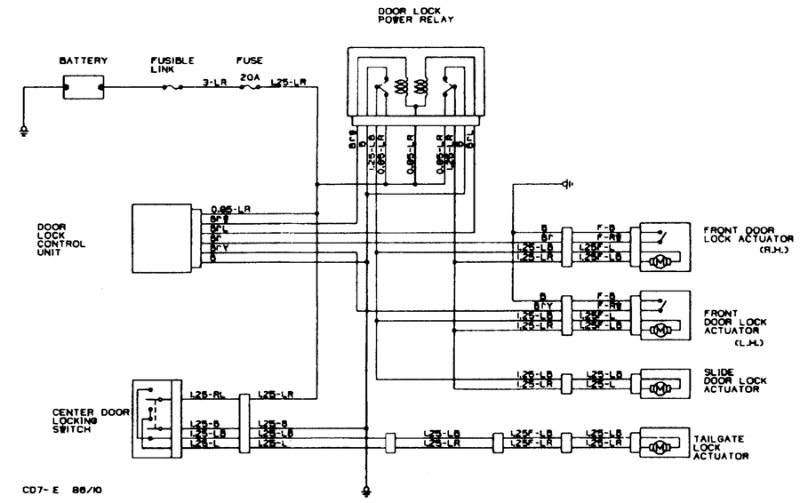

has anybody run into their central locking system working in one direction only? My locks have decided they will lock all the doors.. but not unlock them. I have no signal on the passenger side or slide when going to the unlock possition so i know its electrical. The drivers side lock has a 1 pole switch which sends a lock signal when connection is broken... however when it makes nothing happens. I suspect there is a door lock module tucked up behind the dash that may be at fault but i really dont want to pull the dash to test it if i dont have to. Anybody run into this?
central locking
This may be the circuit for the door. It makes sense to me. I think the driver's door controls everything. I haven't had it all apart but have used it for remote access. The physical movement of the lever must reverse voltage to provide the 2 directions.
- Door circuit
- Door Elec.jpg (8.91 KiB) Viewed 7489 times

i would have thought door switch would be a three way butd only a two way make/break. I will try blow up that diagram and see if its more legible than mine. Cant make out wire colours on mine :)
central locking
From what I can tell some are Blue/Red and the others are Red/Blue with a black ground. I have a larger diagram I could scan if that would help.

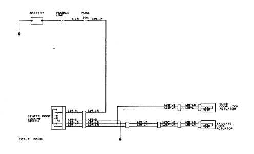

That's the door locking circuit for European vans, where the sliding door and tailgate are both controlled by the "door lock" switch on the dashboard.
Here's a circuit that's closer to ours: it's for Australian model vans. The difference is that Aussie models have a motor and switch in each front door (so you can lock/unlock from either side), but ours only have a switch on the drivers side and no motor (and no switch on the passenger side). The switch is, as you said in your original post, a single pole switch connected to earth- if it closes, the control unit unlocks the doors. If it opens, the unit locks the doors. Or maybe the other way round.
Note that "CENTER DOOR LOCKING SWITCH" is misleading, that's the tailgate switch.
Looking at the diagram and considering the fault (only locks) I'd say you either have a faulty control unit or the 'unlock' half of the relay is burnt out.
