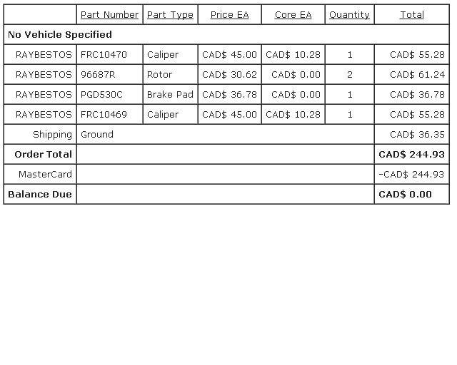

I will be attempting this soon. My rotors have been gauged and the pads are rubbing.
Has anyone tried other brands than Raybestos? I'm comparing prices with Rockauto, but surprisingly, it looks like summitracing is less expensive (then again, there are so many options I'm not sure if I'm looking at the right thing). Did anyone just go to Lordco to buy theirs? If so, what did you end up paying?
nxski
Posts: 3268
Location: BC, Canada
Re: Single -> Dual Piston brake upgrade + auto -> Manual hub
Post by nxski »
Well, I found the search function on Rockauto! :-D
Their prices seem to be the best, as can be seen in the picture. Yes, you have to pay shipping, but it still costs less than Summitracing.
Everything will arrive in 2-6 days to TSB shipping in Point Roberts where I will pay a small fee to pick them up.
The total came to $244.96
subtract core charges: $10.28 x 2
subtract rebates: $15 (brake pads) $5 x 2 (rotors)
Total: $199.40 + return shipping, postage and TSB
I'll attempt to do this myself and hopefully don't run into the same trouble I had last time I tried to remove my calipers.

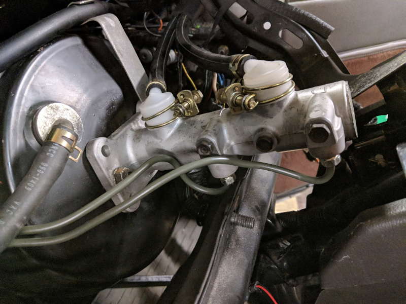

Please note: this is a modification that has not been long-term tested. It's not a bolt-in parts replacement, and involves removing material from the new master cylinder (drilling holes in the flange) so it will work with the L300's existing brake booster. Weakening the master cylinder flange may have consequences, and I'll let you know if anything exciting happens. Unless I'm dead. Proceed at your own risk!
I've had the uprated calipers for a while now, and while the extra braking is nice (the standard callipers felt alarmingly underpowered with 31" tyres) I've not been happy with the pedal feel. The callipers' twin pistons have more surface area than the stock pistons, which means the pedal has more leverage- great for generating lots of force on the brake pads, but difficult to modulate braking power in an emergency stop.

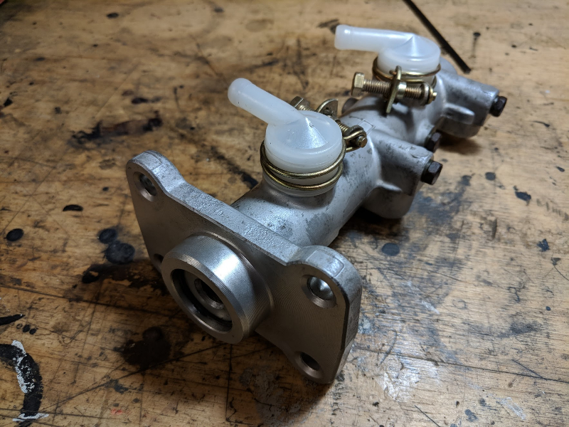

The solution is to increase the master cylinder bore size (stock is 7/8") in proportion to the new calipers' size. And so we come to:
Mitsubishi Rosa/Canter 1" brake master cylinder.
This one was an aftermarket unit, so I don't know the part number. As best I can tell, the genuine part number is MB295330. That's a 1" (25.4mm) bore master cylinder that looks the same as this one. The genuine part is made of cast iron though, I'm not confident how it would stand up to having extra holes drilled in the flange. I've also seen some aftermarket ones where the flange is thinner in the area I had to drill- which is a *really* bad idea.
It's basically the same as the 1" cylinder fitted to some L400s, but with the remote reservoir fittings. (L400s have the reservoir mounted directly onto the master cylinder). It's a 4-bolt fitting, but it's easy enough to drill two new holes. It's MUCH longer than the stock cylinder, but still fits. Just. The brake lines will need to be re-shaped to match the new cylinder's orientation and to clear everything.

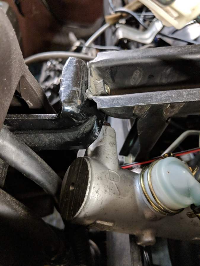

When you remove the old master cylinder you'll see the brake booster has an adjustable length pushrod. You want to adjust the pushrod until it has 0.5mm clearance from the master cylinder's piston when everything is at rest. You'll need to measure the depth of the master cylinder's pushrod hole (using the mounting face as a reference point) and the length of the pushrod (again, using the mounting surface as a reference point).
I had to trim about 2mm from one of the steering column mounting brackets.
Result? A van with 31" tyres that stops just as well as a stock van, has the same pedal feel and pedal effort as a stock setup, and has larger, more fade-resistant callipers.
