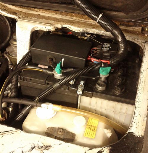

A 2-battery system is easy- fit a second battery and connect it to the first, positive to positive, negative to negative. Here's my old setup:
The box on top houses a bunch of relays and other complicated stuff which isn't necessary for a basic twin battery setup.
