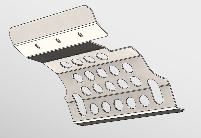

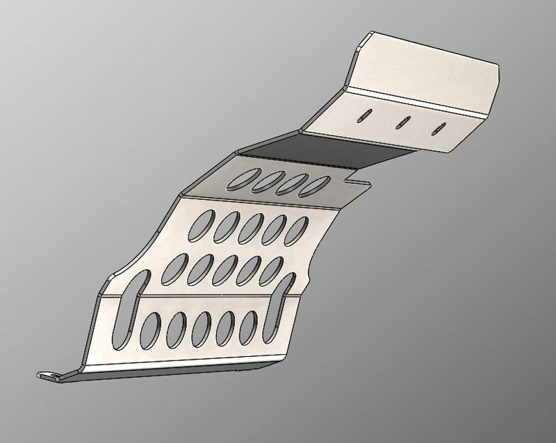

Updated metric drawing, bend diagram and two DXF outlines for download below. One outline has a Mitsumaple and the other doesn't. The outlines are a 1:1 scale and can be submitted directly to a waterjet cutter. Recommended material is 5051 aluminum sheet, 3/16" or 5 mm thickness, hard anodized.

Tojo wrote:Updated metric drawing, bend diagram and two DXF outlines for download below. One outline has a Mitsumaple and the other doesn't. The outlines are a 1:1 scale and can be submitted directly to a waterjet cutter. Recommended material is 5051 aluminum sheet, 3/16" or 5 mm thickness, hard anodized.
First - I want to thank you for sharing this with the community. We appreciate it!
Second, I have a clarifying question about the drawings. On the DXF file for L300 Auto there are 6 bends, but on the PDF profile there are 7 bends. Is the bend that is missing from the DXF file for the two tabs on the bottom?
Thank you!

I can't see DXF files on my tablet, but I fabricated mine using the PDF plans and it fit like a glove on the first attempt. Unless something is bent out of shape, the bend diagram is bang-on.
