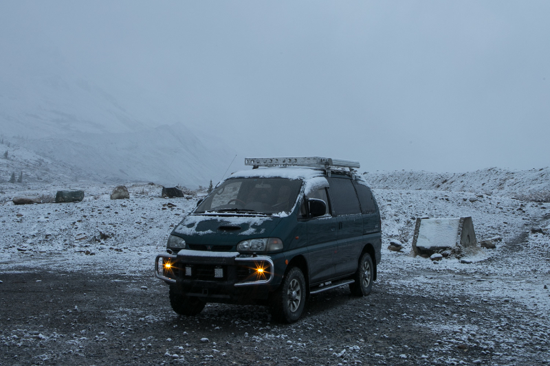

I've got these little yellow LEDs running as DRLs on the front of my van (I actually have them switched inside for stealth mode when required) and they work pretty good.

I'd looked at ordering a set of ones like those myself but then figured I wanted more power and put the big square ones in. I did learn that even with spot beam pattern the distance they throw light is pretty dismal. I've got 48w each on mine and while they light up the ground directly in front of the van like daylight it only goes about 10m but does nothing compared to a set of LED headlight bulbs. For DRLs the 18w ones should do great!
