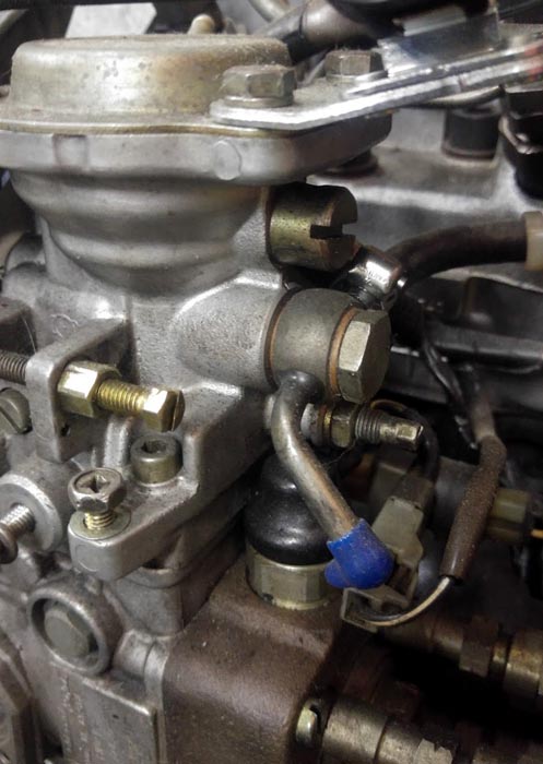

Also I was going to drain and refill the system so I'll know what's in there. The ever so detailed service manual has me disconnecting the fuel cut solenoid connector. I'm assuming this is on the injection pump but where exactly?

You can disconnect the fuel cut solenoid by unplugging the large square connector atop the injection pump. I'm guessing the intention is to then crank the starter to push fluid out? Unplugging the square connector will also disable the glow plugs, so that's a bonus. The fuel cut solenoid is a round black thing at the back of the injection pump. It has one wire going to it. There's a white latching spade connector on a tiny bracket you can unplug, but it's a pain to get at.
And here's a picture showing the white single-pin connector- it's the one behind the blue tube cap- if for some reason you *only* want to disconnect the fuel cut solenoid:
