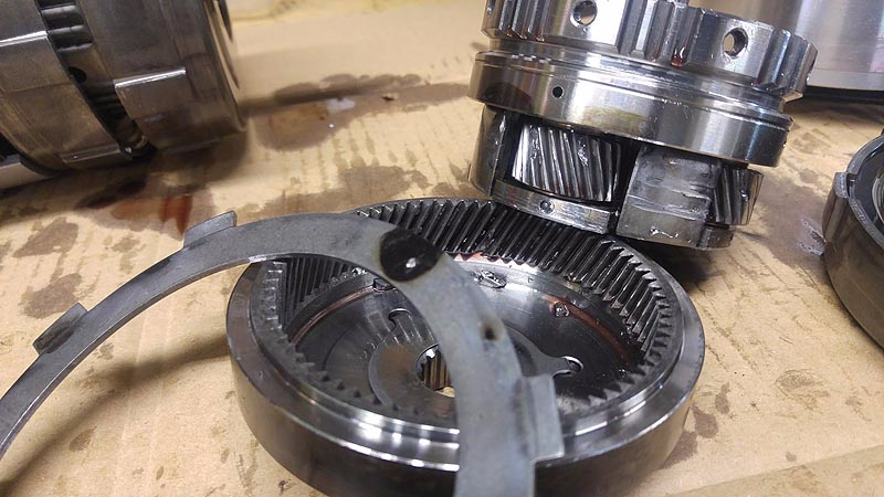

That's the inside of my transmission, which was rebuilt in January: 20,000km ago. Yesterday it started shifting strangely, then it went *bang* and I only had 2nd gear.
The rebuild guys don't know yet what went wrong, but they warned me that it might be a consequence of the extra torque from my brand-new and power-tuned D4BF (which isn't covered by warranty, and fair enough too.) The size of the metal chunks means the transmission is very likely a writeoff- those pieces are just what's made it through the torque converter and transmission coolers, there's far worse still chewing up the gears and bearings.
Tomorrow I'm buying a manual L300 as a donor.

Sorry to see your mess Golden Growler. I noted @ the top of the L300 section you had a recent comment on the use of Dexron IV vs III. Do you think this could have contributed to your problem? As an aside I read somewhere that these transmissions are supposed to be rated for 300 HP. Obviously it must have been an unreliable source!! :-(

lrp374 wrote:I noted @ the top of the L300 section you had a recent comment on the use of Dexron IV vs III. Do you think this could have contributed to your problem?
Possibly, the shifts were quite a bit harder with the Dexron VI in there. It could be that something made of steel couldn't handle the hammering and broke. If the clutches had worn out I'd say definitely.
lrp374 wrote:As an aside I read somewhere that these transmissions are supposed to be rated for 300 HP. Obviously it must have been an unreliable source!! :-(
The Volvo guys use the same transmissions behind some big turbo motors, and they're reliable as long as you don't go drag racing. I suspect it's the torque that's killed this one- turbo gas engines only make their power at high revs, where my diesel is making peak torque around 1800rpm.
north54 wrote:I say we start a gofundme page for Growler to get him some support getting back on the road faster!
I'm grateful for the concern, but please don't do that. It's all under control. Tonight I pick up a 1995 manual L300 and start swapping the bits over. We'll get a "how to convert from automatic to manual" (or possibly "why you can't convert from automatic to manual") tutorial out of it.
...and if my recent luck holds, it'll be followed by "how to rebuild a V5M21 gearbox".

And the results are in: a spectacularly failed overdrive gearset, finished off for good when a chunk of gear tooth got stuck in the OD brake pack, jamming it on.
Likely cause of failure: excessive torque.
The moral of the story: don't use overdrive under heavy load (hauling stuff up hills, overtaking) even if you have the torque to do so.
