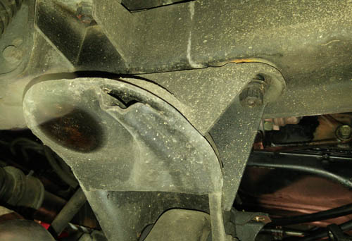

Bad:
No Bushings.JPG (70.28 KiB) Viewed 11834 times

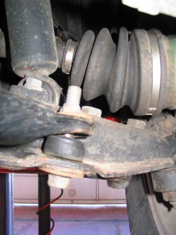

Good:
