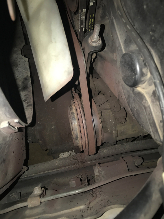

WELL, it happened again tonight and popped it open to inspect. You'll have to excuse my ignorance (i really am not mechanially inclined enough to own such a vehicle), but the pulley closest to the ground and the passenger side door was not spinning. Embarrassed to not know what that is, but happy to learn more with every issue my van has. I've attached a photo and in it you can see some rubber shreds stuck inside the engine bay.
With tonight's incident, I tried to start the van a few times and it continued to scream, so i tried my usual fix - come back in 15 minutes (usually works). This time it started to squeal again and I quickly flicked the key off then back on and it magically started working. WTF????
Also, the cover on the front of that thing is quite wobbly.
Hopefully this photo will be the key to an accurate diagnosis and I can move forward with the repair. Thanks!

Now I'm going to have to be careful. It looks like I've jumped to the wrong conclusion already, and I don't want to do it again. Being wrong twice in one year would be intolerable ;-)
That's your air conditioner compressor. When your AC is off, the little plate on the front shouldn't turn. The pulley the belt rests in obviously *should* turn whenever the engine's running. So you're saying the pulley wasn't turning, and the belt was being dragged around a stuck pulley? (from the shredded-belt splatter on the engine bay walls that's what it looks like...)
If that's the case, take scissors (or a knife) and cut that belt off (it's ruined anyway, and only runs the AC so you won't lose anything else). Also turn off the AC switch, just for luck. That'll solve the problem until you can have the AC pump rebuilt. It looks like the bearings in the front have failed, and it's jammed. Keep the cut belt so you can match the length when it's time to replace it.
The AC compressor is a very common model that was fitted to many Japanese vehicles, not just Mitsubishis. Any AC shop should have no trouble rebuilding it or even finding a replacement. If they freak out at the thought of working on a Japanese import, tell the AC shop it's a Mitsubishi Van/Wagon, just with lots of cool Japanese accessories. Because it practically is.
