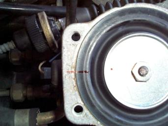

If it's not any of the hoses, remove the boost compensator cover (the metal thing the boost hose connects to) from the injection pump and check the diaphragm inside for splits. **note the diaphragm's orientation before removing it. Putting it back in a different position (rotated) will change your injection pump's tuning**
(Here's a diaphragm marked so it can be replaced the same way:
