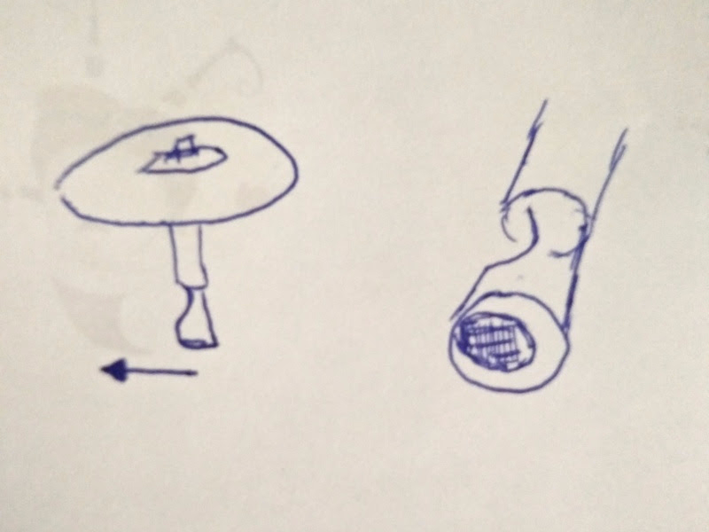

Galium modification,4d56+hp
Just did this mod, but now it feels very unresponsive starting from a dead stop, which may be worsened when it is cold. Like I can put my foot to the floor and nothing happens until is slowly gets to higher rpm/boost. When moving, everything seems ok/slightly better power.
Did i mess up an accelerator adjustment/idle adjustment in doing this or is this supposed to happen?
I'm guessing the sluggishness on takeoff doesn't come with extra black smoke?
The Galium Mod includes winding the spring seat half a turn anticlockwise (http://www.chez-galium.com/automobile.p ... main_frame) which always seems a bit odd to me- that'll put more pressure on the spring, meaning your engine won't inject extra fuel until the boost is higher (which sounds like the trouble you're having).
Try returning the notched wheel to its original position. This should restore your acceleration, but you'll still have more fuel at the top end thanks to removing the nylon spacer. Just watch your EGTs.
The other (rather important) thing that's left out of that how-to is that the diaphragm must be replaced in the same orientation. Rotating the diaphragm changes how much fuel is injected. if you think yours isn't in the same orientation, it's a good idea to remove it again and look at the eccentric cone- there will be a large wear mark on the cone, replace the diaphragm so the wear mark faces forwards (towards front of vehicle) and it'll be back to stock.
No black smoke when I was trying to takeoff..
I turned the wheel back and it feels good again. EGT's climb a bit higher now but I think my 2.5 inch exhaust offsets it.
I thought I would be able to see the wear marks you mentioned when I did it again, but I could not find anything. I did see a bit of discolouration on the botton of the metal pin and oriented that and the oblong part of the pin forwards though. I did not have my phone on me when I did it so I did a terrible sketch of what I'm talking about. I also have no idea if this is the correct orientation but at least the problem has been corrected.
Thanks Growler! I think I owe you a pack of pineapple lumps next time i'm in NZ (my gf is a kiwi).

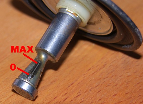

My description was a bit vague. Wear mark should look like this (only without the grease, if you're lucky):
Pineapple lumps are awesome (of course) but bourbon and L&P is better.
This is a governor mod. The easiest on the ve pump. But turning the serrated wheel isn't necessary. The governor pin has two sides aggressive and calm. There are lots of breakdowns if you look up XUD9TE Bosch VE pump modification. The nylon washer acts as an emissions limit and is usually the first thing to go. Looking at the picture earlier of wear marks. You can see the pin has an off set base this is the best indication of the aggression. The delivery is simple when boost starts the diaphragm is depressed a pin follows the line of the governor, this allows more fuel depending on the amount of boost. And of course more fuel=more boost... until the limit what that may be (turbo, max fuel allowance, engine...) any ways from my experience working with the 1.9 xud Peugeot engines there is plenty of potential from indirect injection engines, I ran double stock hp for nearly 2 years before I had any issues with reliability.
Sent from my SM-G930F using Tapatalk
