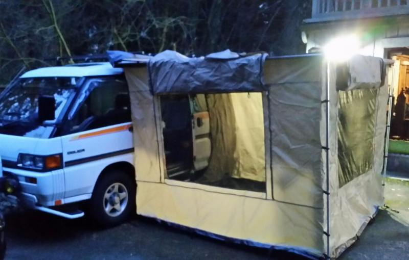

Roof rack
You can use a yakima rack with the highrise kit
- VZM.IMG_20170128_221911.jpg (369.67 KiB) Viewed 11366 times

Roof rack
Your rack pic was a teaser for the tent :) Great setup. Bought/Brand? Made?desertbob wrote:You can use a yakima rack with the highrise kit
