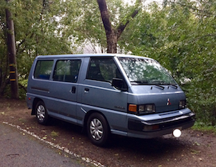

New to forum and new to the Mitsu Vanwagons....Excited to dig into this site a bit more...I've got a 1989 Vanwagon with 184,000 miles on it. No maintenance records on the van...but it did pass SMOG here in California without any issues. Just changed the oil and the van runs great! I was curious if anyone has swapped our gas engines for a diesel engine that they run in Delica's? Also curious on crossover parts for these Vans? Do body parts from Delica's apply to our Vanwagons? Thanks for the help! I look forward to reading up a bit!
~EL PATO
Screen Shot 2017-01-11 at 5.04.31 PM.png (177.82 KiB) Viewed 19128 times
