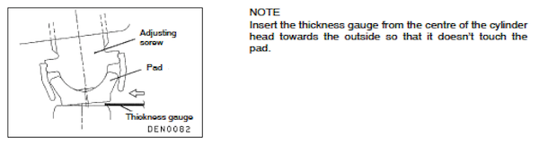

The two manuals in the library have slightly different procedures. The 4G7/4D5 manual has a warm engine clearance procedure at .25mm, and a note to not let the feeler gauge touch the rocker pad... which makes little sense to me as that's what's being measured.

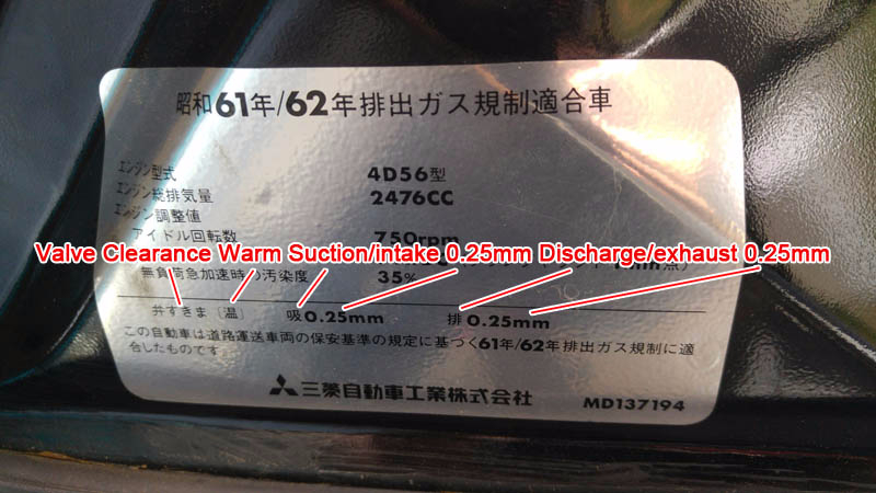

Screen Shot 2016-11-28 at 3.35.51 PM.png (45.15 KiB) Viewed 1823 times

Yeah... there's two different settings depending on year and application. Early engines with protruding valves are 0.25mm Hot, later engines with flush valves are 0.15mm cold.
On the underside of your engine cover should be a silver sticker on the passenger side. It's mostly in Japanese, but if you see "0.25mm" on it then your clearances should be 0.25mm when the engine is hot.
