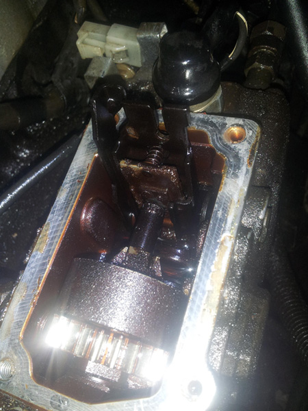

That was not a very good picture. Here is the original: http://imgur.com/UmI2ZMR
I actually did check all those things - aside from running the turbo with the hose off and checking under the rocker cover (a good idea since I put a new head on about a year ago and completely forgot to seat the valves)
But yea, Cracked open the IP with the idea to check the condition of the governor spring complex. Ended up seeing a lotta crud. Veggie oil looking gunge. Pretty sure it was nicely softened up by all the injector cleaner and atf i had been running through - just peeling off and gooping up all over the place. Seeing that I figured might as well try the pump off my parts van. Managed to do it without even removing the lower timing cover or any of the rest of the v-belts!
Runs good now.
I've gotta post this picture in all the veggie forums (will do in the delica.ca veggie forum in the thread I already started over there) would like to figure out what caused this. I've clearly been to sloppy with some aspect of the WVO handling, or not purging long enough... I would like to know so I don't have to repeat this in another 50,000k
Does anybody know where to get one of those handy dandy little stainless gauze screens that are supposed to be under the inflow banjo bolt on the pump? I bet my lines between the filter and the IP are full of crap too now...
Re: Sudden loss of power.
That is truly gross. No wonder it wasn't running properly. Still, now you get to disassemble, clean, and reassemble an injection pump! Fun!

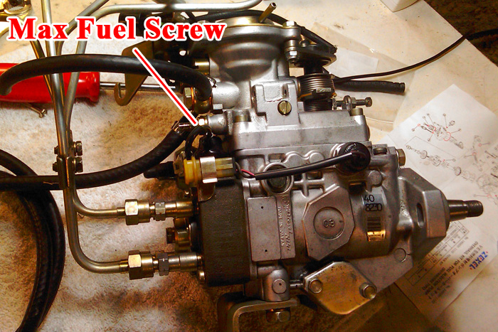

The new pump smoking: does it smoke only under heavy boost, or most of the time? Most of the time: Try turning the full load adjusting screw (10 in the Bosch diagram, also called the max fuel screw) in a half turn.

only under heavy load, Such as uphill, or even a bit of smoke under heavy acceleration. I just assumed my timing was off, but i could try the max fuel screw!

Thank you so much, good to know. It really seems to be more of a heavy load smoke show. But then it does smoke pretty good. I really feel like i did a bad job on the timing, so i kinda want to get one those dealies. But maybe i ought to check the max fuel screw... because that sounds much less expensive.
