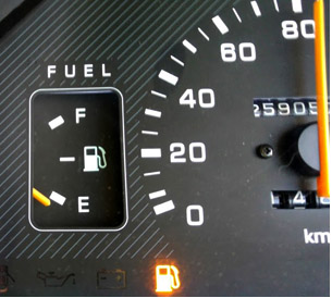

I finally got around to figuring out why my low fuel light never came on- turns out it was perfectly functional, I just never ran it low enough. Usually I get nervous and fill up when the point of the needle reaches the lower part of the Empty mark.
Most vehicles I'm familiar with turn on the low fuel light just before the gauge reads Empty. This is where my gauge has to be before the light comes on:
There has to be something wrong here. I travelled another 150km between the lower end of the E mark and when the light came on. What's the point of a fuel gauge if Empty doesn't mean "empty"?
Re: fuel tank question
I measure each time I fuel. I've also run my wagon "dry" once. I think the fuel light is meant to come on at the sixty litre mark, although mine typically fluctuates between the 58-60 litre mark. A lot of times it will be affected by the climate pressure, This weekend I was up close to fifteen hundred metres and by the time I got to Logans Lake the light had not come on and I put sixty-one litres into the tank, perhaps the bulb has burnt out. Either way the diesel L300s have a capacity for 75 litres so with the light coming on for me I know that I've got roughly fifteen litres left and depending on the driving I'm doing (city or hwy.) I can plan accordingly.
I think the mark on the dial means empty and the light means "have you not noticed? I'm really empty".
Growlerbearnz wrote:There has to be something wrong here. I travelled another 150km between the lower end of the E mark and when the light came on. What's the point of a fuel gauge if Empty doesn't mean "empty"?
