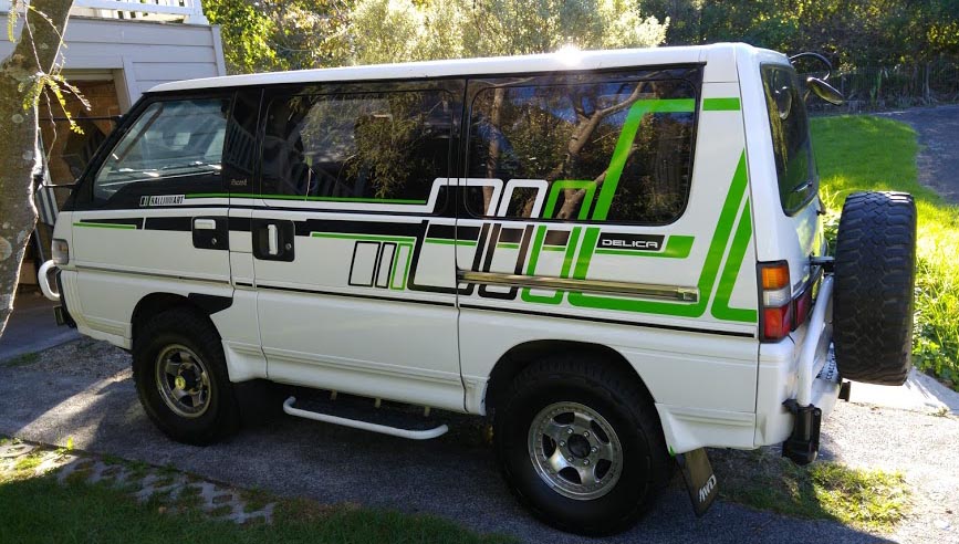

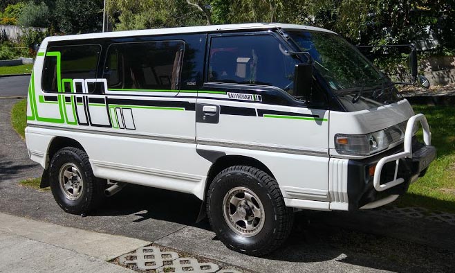

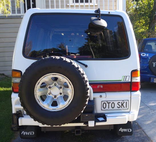

Applied new graphics. I went for a Ralliart-inspired version of Delica graphics. Might have gone slightly overboard on the sides but kept the front and back subtle.
Removing the old graphics was the trickiest part- a hot air gun to warm the panel before gently peeling them off worked the best.

Wow!!! Very well done, like the colour, design and the initiative.

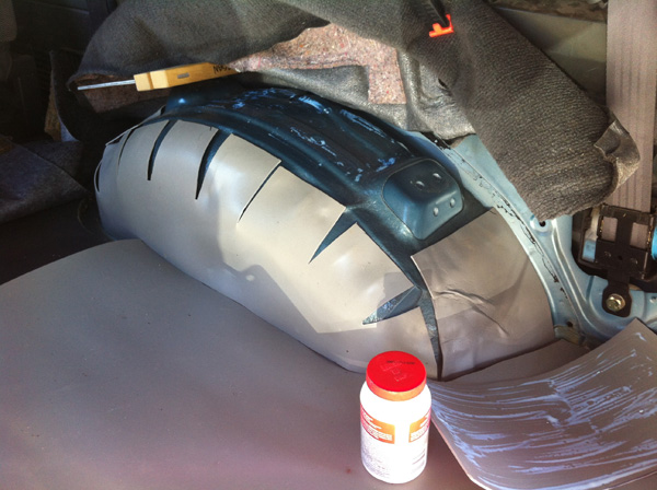

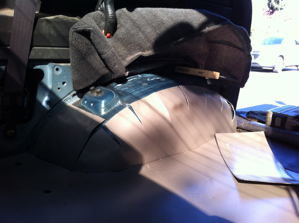

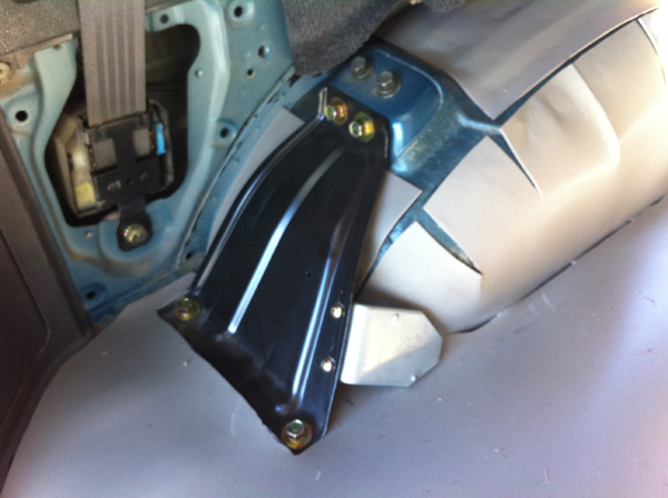

I added a layer of foam insulation in the back and wow! did it ever make it quieter.
I read an article that said that one of the differences between economy cars and luxury cars is, luxury cars have better insulation, that absorbs road noise. I looked up products for cars, and they're closed cell foam. I happened to have a roll of closed cell foam so...
This stuff is around 3/32" thick, barely anything. I rolled back the carpet and cut pieces to fit the floor and over the wheel wells. I stuck it down using LePages water-based contact cement. I sleep in the back camping, so I didn't want anything that releases fumes. This stuff takes 40 minutes to set up, but I just interspersed it with other minor repairs.
I can hardly believe what a difference it made to road noise! Now I hear more from the front than from the back of the van. I'm going to apply more insulation up front over the wheel wells, and quiet it down some more.
Oh by the way...does anyone know what those pieces of metal are bolted behind the wheel wells? Either they're something to do with the back seat (which I've never put in) or they modify the appearance of the humps in the carpet to be more aesthetically pleasing.

I'm wondering if it's some sort of anchor for something in the wheel well, perhaps for the mud flap?Morganizer wrote:... Oh by the way...does anyone know what those pieces of metal are bolted behind the wheel wells? ...

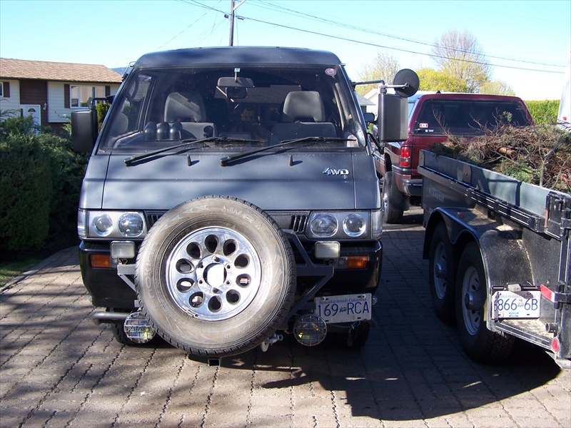

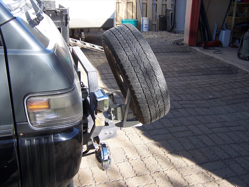

I finally finished the last phase of my winch project. I made a spare tire carrier to use the 2" receiver type hitch I installed as part of the winch. It sticks out a lot farther than I planned but the good news is I can use it on the trailer hitch @ the back.

Nice! Though my immediate thought was...

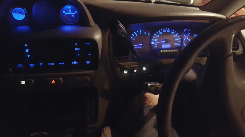

Changed out some dead dash and switch bulbs with leds.
Wanted a red but ended up with a blue, which looks pretty nice. Red was just to dim. All the warning lights and other also got changed to the appropriate color led.
The bright white switches to the lower left of the steering wheel just didn't light up at all. Most were actually missing the bulb holder. Soldered led right to the posts.
The rear defroster and hazard were burnt out. They got replaced with leds as well.
