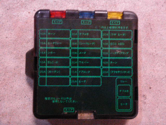

Should I assume the "electric door lock" is the "electric window" fuse on the L400? Did I miss something? :?

Re: fuse box translation
I believe the "electric door lock" fuse is too small to also run the power windows, I think those use the 30A under bonnet fuse marked "back window".

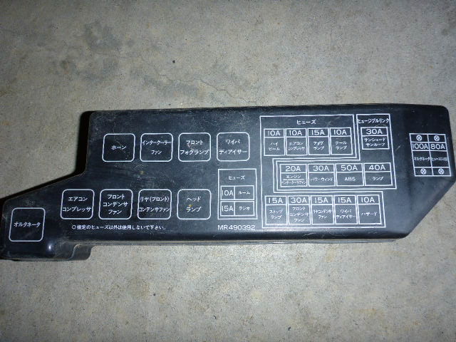

Any chance you could post a photo of your under-bonnet and interior fuse box lids? I'm beginning to doubt the accuracy of the translation in the pictures I posted, I can probably do better...
Post by thelazygreenfox »
Hey GB here's the pics
:M :M
MD
The 30A under bonnet fuse (between the 20A and 50A) is "power window".
