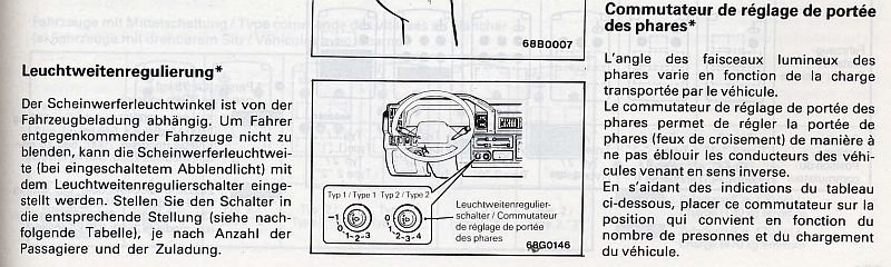

The square recess in the dash usually houses the idle speed control- lets you set the idle speed a bit higher than usual until the engine warms up. The square hole in your dashboard is not standard though. Maybe you could add a power socket there to hide the hole?
The shiny bracket is unusual, that spot is usually left blank. Looks like a CB radio handset bracket.

On my L300s, next to the cigaret lighter sits the electrical headlight range adjuster. This is an option in Europe, not all models have it.
The headlight range can as well be adjusted manually using a Philips screwdriver, under the headlights.
Mind you, I have a left hand drive vehicle, so this is right-left reversed.
