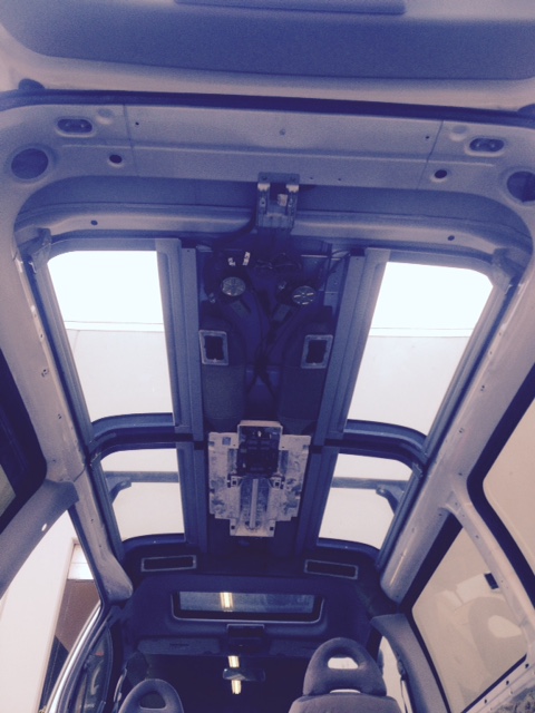

Has anyone peeled the roof liner out? .. I have 2 issues.
1st. One of the motors will only move a rear blind a 1/4 closed.
2nd. I'm mounting cabinets and don't want to drill mounting screws into a track system or even worse the electrical!
Any advice would be greatly appreciated!

Shortly after posting this I had a look through there.. I think this weekend I'll peel the cover out and take some pictures. I need some sturdy mounting points and the manual isn't showing where the wires are run or where it's solid. Simply, how to remove it.

So I opened it all up.. the rear(larger portion) came loose relatively easy with shop manual parts diagram order of removal. The tough part was the front (As it was listed first to remove and I obviously did is second thinking it didn't have to be done at all). Anyhow, I found a metal rod was jamming the slider on the rear blind (sunshade). Fitted back in place and it works like new!
Then I fixed a 3/4" metal strip in between the (driver side) blinds (And one in between the front crystal lite and the roof vent) to secure some upper cabinets to.
The whole process took me about 5 or 6 hours.. 3 of those were mucking about with the mounting hardware. From what I've read online, any blind or sunshade with movement can be fixed without any replacement parts. If it doesn't move or make any noise, I think the motor would be fried and you're outta luck.
Here is what it looks like without the lining.
Thanx for the pix
