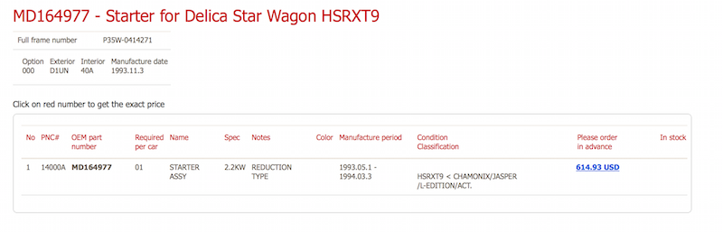

Like Muk (see a previous similar post on finding starter parts), I'm not finding my part number for the starter. I have a 1993 L300 with 5 digits HSRXT
In the link: http://www.partsbase.org/mitsubishi/del ... 1986-1999/, I get these images. I'm not sure how to find my '93 in there (for the complete starter assembly).
For example in Image 1 and 2, for the starter assembly, I see for part number MD164977 a period from 1989 12.3 - 1990. 07.3 (no 1993 implied?). Also, per Falco's advice (and thank you for doing this Falco on behalf of so many of us!), I have gone to the jdm parts catalogue but get an error before I can proceed (error message image).

I finally found the link to the JDM Parts Catalogue. For some reason I couldn't find it in the FAQ section.
Because I was curious, I entered your chassis # P35W-0414271 and navigated to the starter assembly. It shows OEM part # MD164977 as the one that fits your Delica
(1993.05.1 - 1994.03.3 HSRXT9 < CHAMONIX/JASPER/L-EDITION/ACT.)
