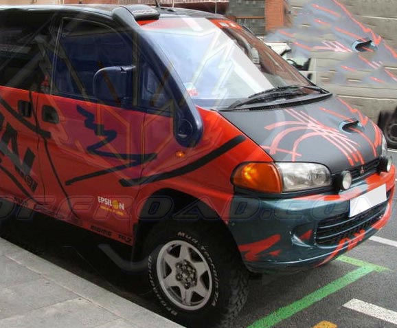

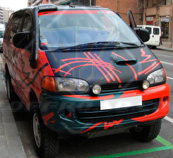

Started to make the mold for my custom snorkel. Had some blue styrofoam from an earlier project. Saw this stuff used on a 4-runner project on the IH8MUD forum..
http://forum.ih8mud.com/threads/diy-hom ... el.485105/
.it was really slick, looks like most other jeep/toyota snorkels and his cost was super cheap! I like cheap!
here's at least a few inspirational pics of an interesting variant from Spain...uber pricey @ over 600 euro's!!!! Kinda hard to justify a $1000.00 CDN for that item.

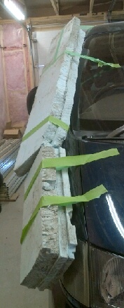

Here's the start...rough slabs of blue densefoam. This is a 'when I have time' project. Expect slow steady progress as I work the shape.
As for why I am doing this. I want to see if I can do this project justice. If I have enough nerve to.drill into the fender is a whole other realm.
