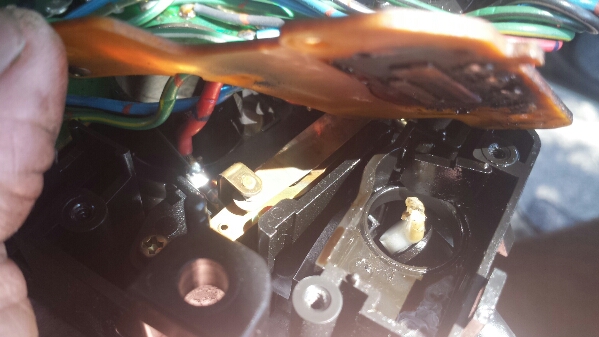

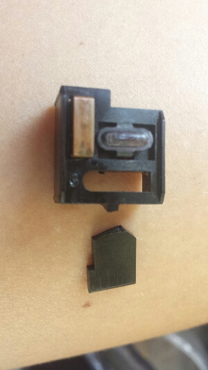

Hey guys....have some really good news !!!!
Took the steering column apart following the thread Lapprentis linked us to and found our problem....shifting carriage was snapped (see photo) and also the little plastic shifter beam that is connected to the stalk was melted and was no longer long enough to actually move the carriage between settings when the rotator is turned (see photo).
...hope this is making sense.
After some fiddling around with prototypes, we decided our best bet would be to try and graft some Jb Weld PlasticWeld epoxy putty onto the end of the plastic shifter to increase it's length. We also used the putty to repair the shifting carriage !!
All working good as gold now....not sure what the durability of the repair will be...hopefully long enough to at least get us to a repair shop back in BC. :)
