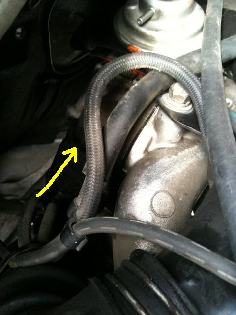

Wow pulling the drivers seat and lower panel was not fun. I think the gas lever and ebrake have to be disconnected as well??
The arrow points the wet oil spot above the turbo. There is a large black pipe held on with a screw clamp and the two small lines connected to this area were wet as well.
Is there another possible leak location other than the turbo? (just above)

Could it be that your valve cover gasket needs replacing? Mine got to the point that my entire undercarriage was coated with oil.White Mule wrote:Wow pulling the drivers seat and lower panel was not fun. I think the gas lever and ebrake have to be disconnected as well??

There is not that much oil. About a drop or two makes it to the ground.nxski wrote:Could it be that your head gasket needs replacing? Mine got to the point that my entire undercarriage was coated with oil
I was looking at the 4d56t diagram of the turbo and exhaust manifold and noticed an oil hose pipe and connector.
