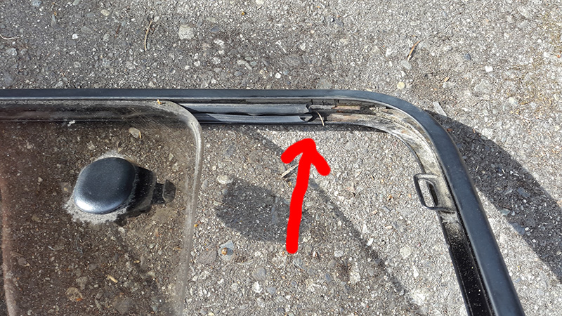

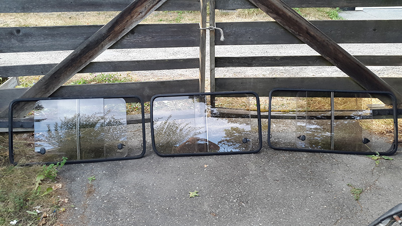

Thanks to this amazing community I have managed to source sliding windows for my L300 Delica. I have three of them. Two for the right side and one for the sliding door.
Now, while the frame and the glass is in perfect order the rubber seal inside the channels is all brittle and falling apart. I would like to source a new run channels, find someone who does this kind of service or learn what would be the best way to deal with this issue.

I actually have three sliding windows. Two of them came from driver's side and one came from sliding doors on passenger side. Two of them appear to be identical but when put side by side there seems to be a slight difference in length - maybe 5mm.
Someone has told me the following part # for my windows and now I am slightly confused: MB416314, MB416313 and MB478209

The smallest window of three comes from passenger side and is the very back window and only one part of it opens up. Could you have a look at all those numbers and help me through the fog here?
