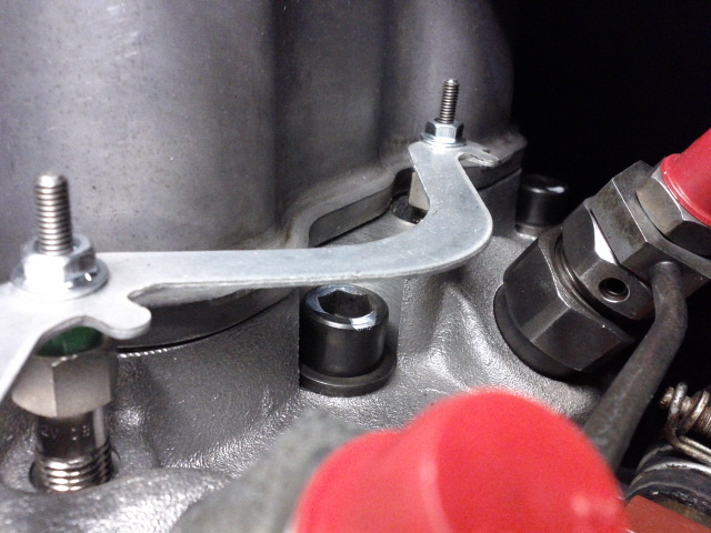

Sounds like you've got it sorted- yes, both wires connect to the same place, usually the second glow plug from the back, and from there the power runs along the connector (bus bar) to the other 3 glow plugs.
Here's a photo of my new Mitsubishi glow plugs when freshly installed- there's a fair amount of thread still showing. (The engine is nowehere near that clean now!)

What a beautiful engine & photo! That will be of great help to the next person.
Actually, I wish I had another one to do. It would be fun to do the job in 1/10 the time :-) In my Delica, the engine is under the seat. Half the challenge is the gymnastics involved.
