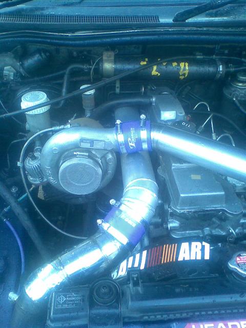

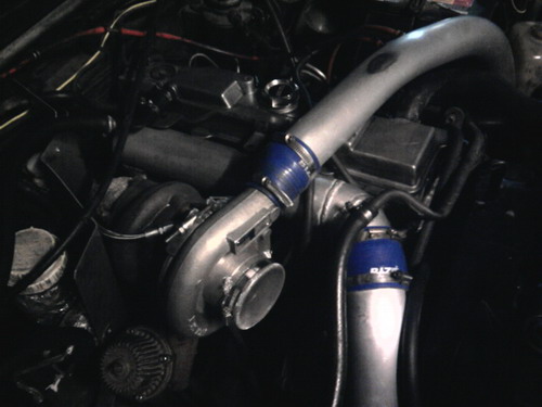

Just thought I'd post up some photos of people's 4M40s in Thailand. They are all in Mitsubishi Stradas, but the engines are all the same as our JDM Delicas and Pajeros with the manual/mechanical IPs. They're mostly set up for drag racing, but in milder configuration these should yeild good power figures.
The turbos these guys are running are mostly BIG externally wastegated Holset and Garret mounted on custom tubular exhaust manifolds. Big front mount intercoolers, solid intake pipes with custom intake manifolds which are just the stock intake runners welded to a big alu tube. The rub here is to supply enough fuel to make use of this setup they need IPs with bigger plungers. I read some are bored to accept 11mm plungers. I don't know what is in the stock pumps that we have, any one who has rebuilt their pump measured the diameter of the plunger? I have a feeling it's something like 9mm. I have now idea about engine internals, but they probably have some porting in the heads, but i've never seen any connecting rods available for the 4M40 so I imagine everything else is stock.
I believe these 4M40 are producing something like 300HP and 600ft/lb of torque. Which is pretty impressive to say the least. So the 4M40 can certainly be a performance power plant.
In any case there is certainly room to increase fueling on our pumps significantly before they can't manage. These Thai 4M40s are running something like 30psi intake pressure so they need more than three times the fuel that the stock pump is set up to deliver. I'm interested in running about 17/18 psi with a much smaller TD04HL-20t turbo, so the stock pump with some tuning to the delivery should be able to provide enough fuel to have a decent mixture. With the HL turbine housing the turbo should spool at about 2000 RPM and remain streetable.
Anyway, on to the photos:
