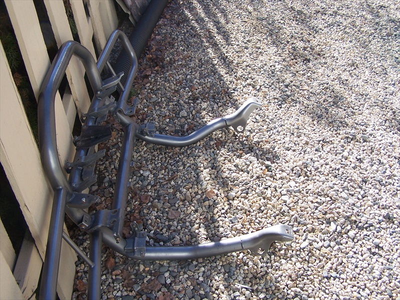

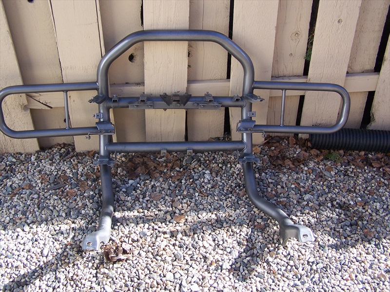

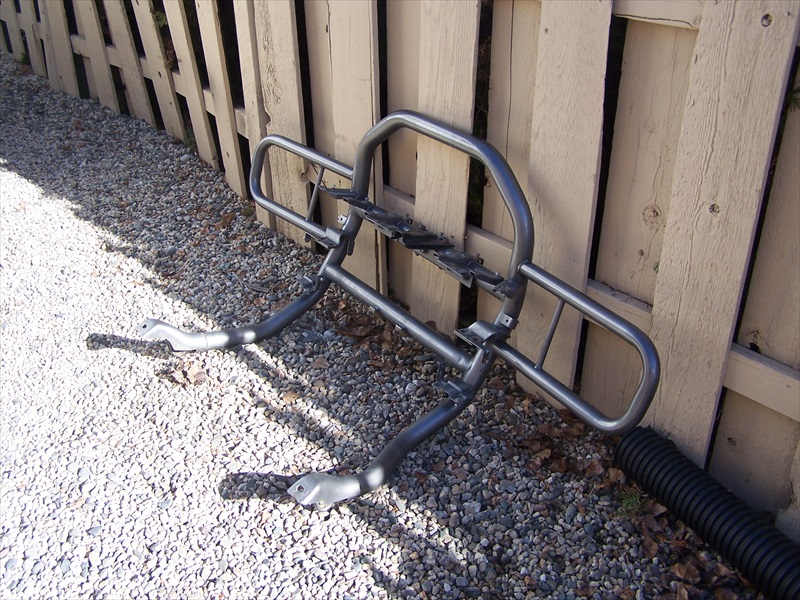

I have my Bull Bars off @ present. I've taken a few pictures. Let me know where you would like measurements.
- BB-FL_003.jpg (306.88 KiB) Viewed 4312 times
- BB-FL_002.jpg (249.98 KiB) Viewed 4312 times
- BB-FL_001.jpg (260.61 KiB) Viewed 4312 times

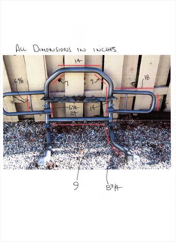

HI Irp
I really appreciate about your replay. Unfortunately image is not uploading i tried few times but i could not upload the images. can you do me a small favor i need all the bend length, height, width between bars and etc.with inches. because i am going to produce a bull bar for my Delica.
User your same image and edit it with measured inches sizes. then Please attach here so i can use it.
Please replay me ASAP.. This is Argent..
TAKE THE LAST IMAGE AND DO THE EDITING PART

Re: Delica L300 Bull Bar Standerd Measurements?
I've attached the pictures as PDF's so you can download and mark-up as you see fit. The bending of the main supports is quit complicated so it will be difficult to measure as you will need multiple bending angles and I'm not sure how I could measure them.
Hi Larry,
I can be able to see you attached images. Thank you very much for that. but the thing is i can not upload images to this site from my location. Therefore i attache the edited image to MediaFire please follow the below link then you will be able to see the image. In that image i have marked the red lines so i want that area length in inches. i hope you will be able to see the image. If not please let me know. Sorry for the bothering..
http://www.mediafire.com/view/ma724ks9q ... 01_NEW.JPG
Really appreciate your help.. Expecting quick response. ..
I've added the dimensions you wanted in a jpg attached. I hope you can read what I sent. The site size limitations would not allow a pdf.
Larry
Larry
- B Bar005a.jpg (137.68 KiB) Viewed 4222 times
Hi Larry,
Brother, thank you sooo much. you did a GREAT HELP for me, this is really useful for me.
I am really appreciate your quick respond. Yes, the images is clear.
