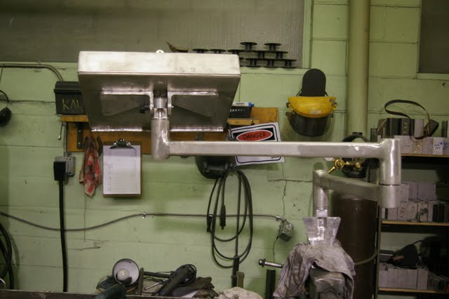

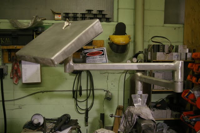

I use a laptop with a Garmin ordinance survey configuration that I have mounted on a positionable platform that's mounted from behind the driver's seat and can swing in a number positions:
I usually keep it between the seats where I can quick reference it from the rear view mirror. Thinking backwards is not difficult for me as I'm well acquainted with reading backwards from my sign writing days in the UK. If I need to make accurate projections I just stop and focus.

Re: Tablet mounting solutions?
Oh, I've gone camping, as well. The platform doesn't use up that much space. Although I do have a nice tent with cots and a rug, tables, &c., if I'm going out by myself and not planning to stay for more than a night, I sleep in the wagon and the pentagraph doesn't get in the way. I designed it specifically for going out into the toolies, which is why I've loaded an ordinance survey map into the programme. The reason I went for the laptop over say the usual GPS units is because; A/ I want a bigger map; B/ I want detail.macro wrote:Falco, that thing is intense! I don't think that would work for us because if we're using the GPS it probably means we have a bed set up in the back and are going camping.

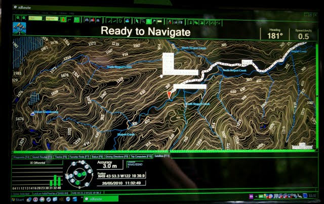

One of the neat things about this set-up is that I can use it in concert with the altimeter to determine the weather.
What I mean is this:
- The altimeter that comes with the Delica is a barometric altimeter, that is to say it works off the pressure of the environment the wagon is in. The Garmin programme that I'm using also has an elevation feature that is not barometric.
Let's say we drive into a valley and I wish to ford a three foot deep creek. Because I have a bigger map I notice that a little up stream there are a dozen other creeks feeding into the one I want to ford. Also looking at the bigger picture on my monitor I realise that there is no other way out and I'm going to have to come back the same way. So I check the elevation feature and it says I'm at 1,258 metres, I check how many satellites are tracking me and I see there are five strong signals, so I know that this reading is pretty accurate. Then I look at my barometric altimeter and it's reading that I'm at 1,823 metres. The lower the environmental pressure the higher the needle will read on the Delica altimeter. This tells me that because the barometric reading is greater than the satellite reading that I'm in a low pressure zone, which means weather/rain. If I ford this three foot deep creek and then it rains, when I come back it might not be three feet deep anymore, it might be nine feet deep.
This is one of the reasons I went with this set-up. I can also watch movies on it (it's hooked up with the sound system) and although I typically wouldn't watch movies in the toolies when I've escaped society ~ sometimes the passengers might need a little distraction. Also great for bush parties ~ not long ago I had Led Zeppelin live at the 02 Arena on at a barbeque, went down really well.

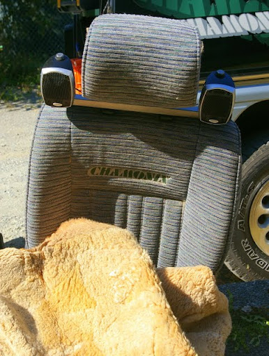

yojimbo wrote:Sheepskin sheep covers man, feeling the sticky love. ...
Got the idea off of DeliCat, It is more comfortable than the stock upholstery, keeps you cooler in the Summer and warmer in the Winter. I also restuffed the driver's seat with memory foam and a gel pad. If you look closely at the shoulder section of the driver's seat you'll notice that the sheep skin also covers my HAM radio speakers.
