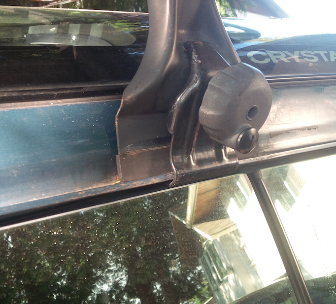

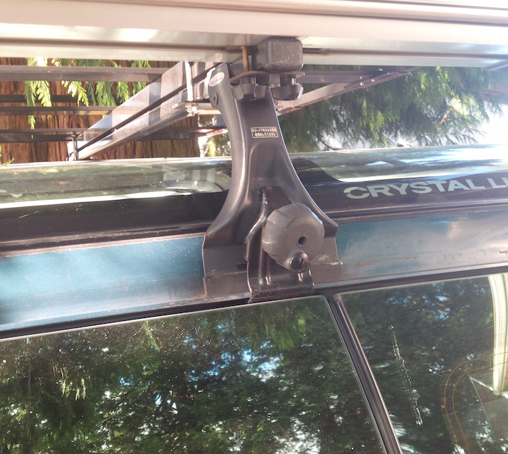

This may help. I was installing my roof rack and basket on my L400 a couple of weeks ago. I knocked the molding off that trims the edge of the rain gutter. It turns out there is a substantial rain gutter under that molding. The molding is held on with some plastic clips. The clips are glued on (or stuck with two-sided tape) every couple of feet. I took off the molding and can see that the feet of the roof rack are quite solid.
That molding does get in the way a bit when installing the feet of the roof rack. But its not too bad.
Here are some pics attached to show you what I mean. I will need to put the molding back on at some point when I get time.

Oops, this one didn't attach for some reason.
- Roof 1.png (760 KiB) Viewed 6016 times
