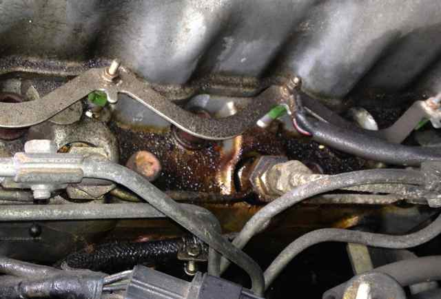

I have attached a photo showing the injectors, I have noticed one is looking a little off. Should I be concerned?

Firstly...you drive a diesel (glow plugs and common power rail photo) not a gas unit which has a different series of potential sources for sputtering engines.

As for your picture don't worry about the crap around the injector. Look for fuel bubbling, that kinda stuff.

I think he was referring to gas as in the pedal. No biggie.
Also he was pointing out the injector below the rail. It's got a bunch of crud around it.
