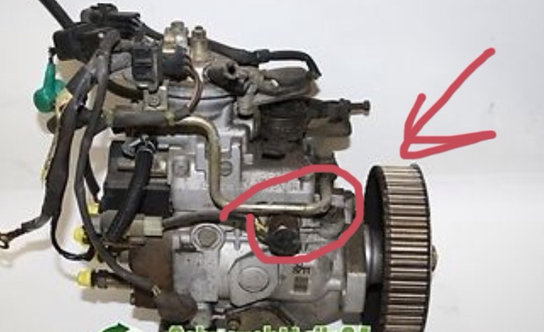

Hello
I recently purchased a engine from used from a space gear and need to know what the circled item is in this picture of the injection pump. Any help would be greatly appreciated.
Help identifiying component 4d56
- IMG_0834[1].jpg (92.76 KiB) Viewed 3225 times

There are very few 2WD L400 in Canada. That model could have either a gas(2.4L) or diesel(4D56) engine. Most of our membership associate the bigger 4M40 (2.8L TD) in the L400 and the 4D56 (2.5L TD) in the L300 because these are the most common variety we import.
The piece you had asked is a timing solenoid. At least according to the manuals for the 4D56 fuel system. For future queries perhaps a look through the technical manuals would be helpful.
