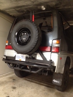

Hey guys, I have had numerous enquiries lately about my rear bumper/tire carrier on my Deli, so I thought I would put the info here for others to use at their will, just as I did with this mod. This is a good way to go as you simply can't buy the steel/hinge,latch and paint etc for the cost of these units. I paid 319.00 total shipped to Blaine Wa, no duty was charged bringing it back. This particular bumper is 62" wide, (1.5" narrower than the Deli body) and only 9" out from the body (only a few inches more than stock) and follows the lines of the Delica very well (IMO) and had one of the nicest latches I have seen. These unit are no free ride as far as welding and fabricating though, as Jeep's have a much smaller rear door so the swing pivot/latch need to be removed and relocated further apart to clear the door. (DJ notched his door, I didn't want to do that though)
As many of you know, this is simply a modified version of a jeep Wrangler "rock crawler" aftermarket bumper that was first posted by the DJ in an older thread. I bought some cruiser wheels off him, and when I saw what he had done, I knew I would eventually follow his lead. I hope he doesn't mind me taking his original idea, but he strikes me as a guy who wont mind the tribute!
I wont waste time explaining the same process as he did this in his thread. I will simply state the changes I made to the design and show some pics along with it. I wanted the bumper/carrier to sit close to the door and not reduce departure angles, I also wanted a true receiver that anchored to the frame not rear apron. I also wanted a usefull "step" to access the roof/load stuff into the van.
I used the existing frame holes behind the rear shackle..drilled out to 1/2" instead of drilling and bolting through the side. I chose to use one vertical 1/2" grade 8 bolt per side (along with the two 3/8" rear fasteners per side...6 bolts total) as I do not intend to tow anything of significant size, but to drill and install 2 additional bolts would be little additional effort for those concerned.(shear is still above 12000lbs)
I prefer this design as it will draw the 2" x 2" tube up into the rail and not have to worry about clearances to the shackles. I also skipped the adapter plate and simply welded the 2x2 1/4" wall to the bumper itself. I liked how close it would sit and always prefer to use less bolts when possible. I do actually certify welders as part of my job. (materials engineering) The welds were mag'd and should prove waaay stronger than necessary!
I'll post pics with the swingout installed after I finish welding/painting the extension. I did have to relocate and weld the pivot/ latch perch to allow clearance for that damn 53" wide rear door as can be seen below!!

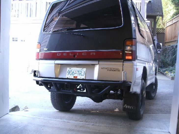

All done...works very well, and the deli does indeed handle better with the additional weight out back.
Tire Carrier.JPG (51.75 KiB) Viewed 6190 times

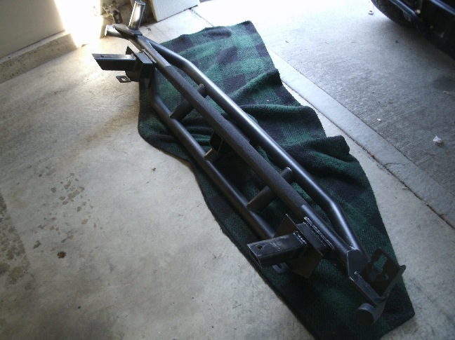

A good view from the back through to the frame..note the existing 2" tube support already inside the apron.
GEDC0003 1.JPG (92.46 KiB) Viewed 6306 times
The bumper supports sit 37.75" apart (inside dimensions)  Slide in nicely into the existing holes in the rear apron.  Note how similar the Jeeps frame mounts line up compared to the Deli...almost on center!!

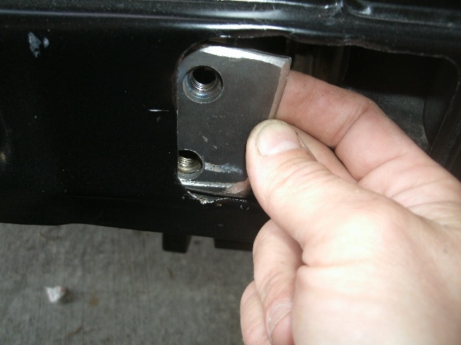

3/16 steel plates with nuts tacked to back slip into the apron holes to allow the bumper to be anchored securely to the rear van apron from the outside.  I used two  1/2" machine head Grade 8 fasteners per side.  The pic was taken before the holes were drilled for the plates.

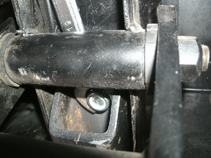

Easy access with 19mm wrench from the bottom through shackle, it sits there nicely while its tightened from the top.

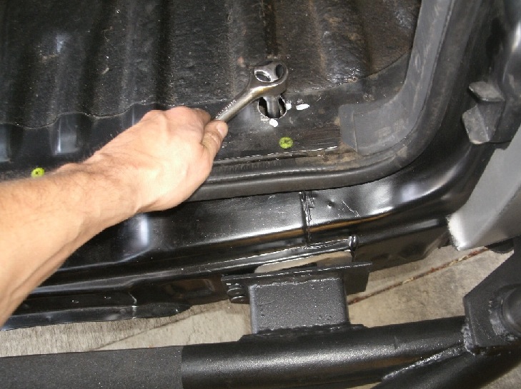

GEDC0007 1.JPG (161.26 KiB) Viewed 6308 times
Drilled 1" hole for socket access.  This also enables the use of 1" long bolts directly on the frame rail.  Note that the front 3/8" bolts will draw the bumper inside the apron before the vertical bolts are torqued.

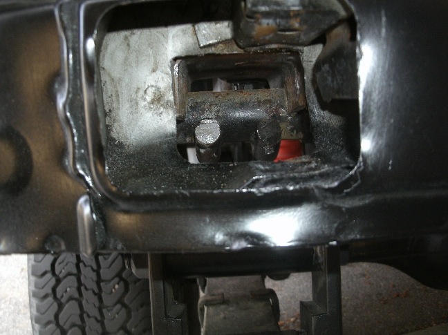

Great clearance, and a "tidy" appearance.  Note that the receiver pulls almost directly at frame level:)
GEDC0013 1.JPG (128.74 KiB) Viewed 6308 times

there you go Jay, I tried to post more pics (side profile/clearance etc..) but mod said no dice:(
