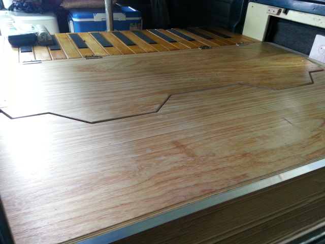

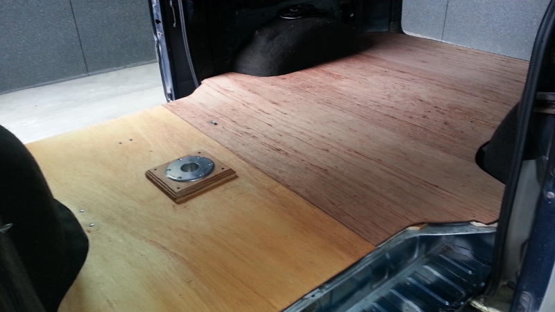

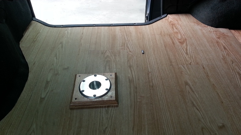

Laying the floor
Laying the floor
Laying the floor
Waterproof plastic flooring
Waterproof flooring
Waterproof flooring

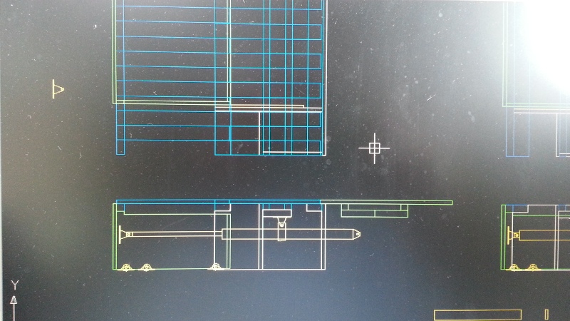

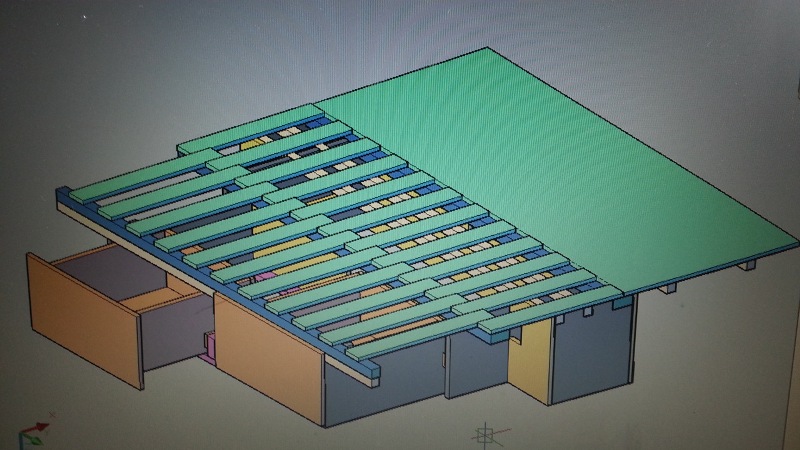

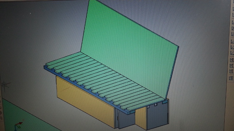

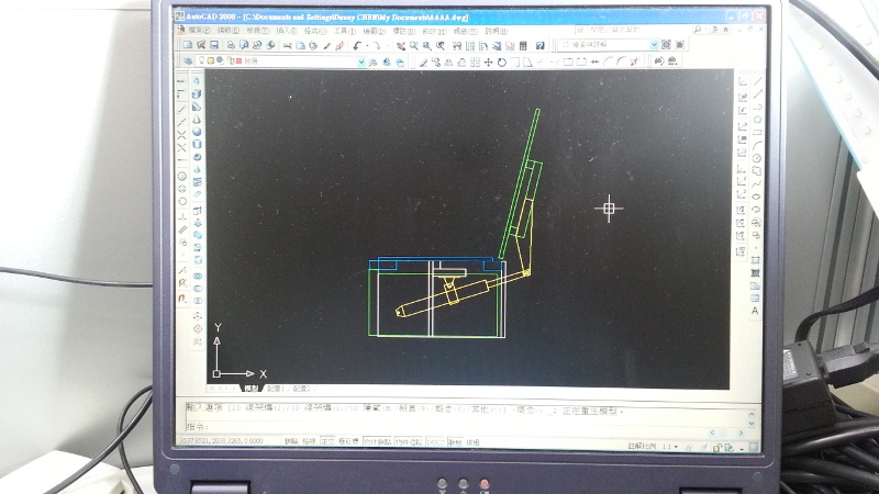

Interior design and simulation
Interior design CAD1
Interior design CAD2
Interior design CAD3
Interior design CAD4

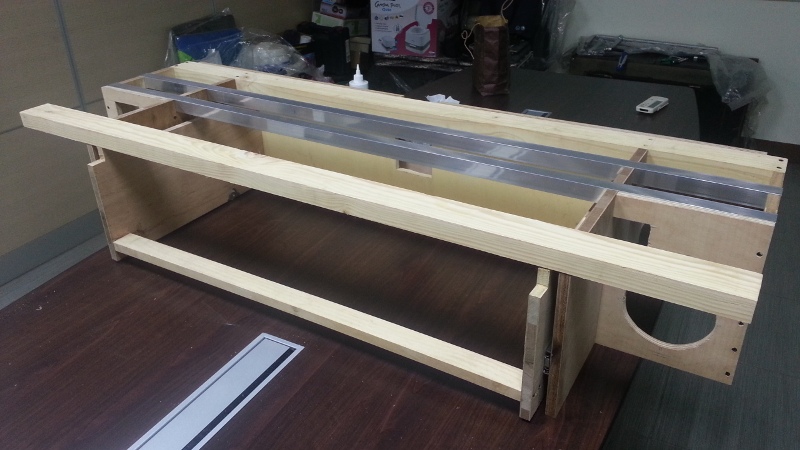

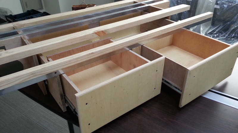

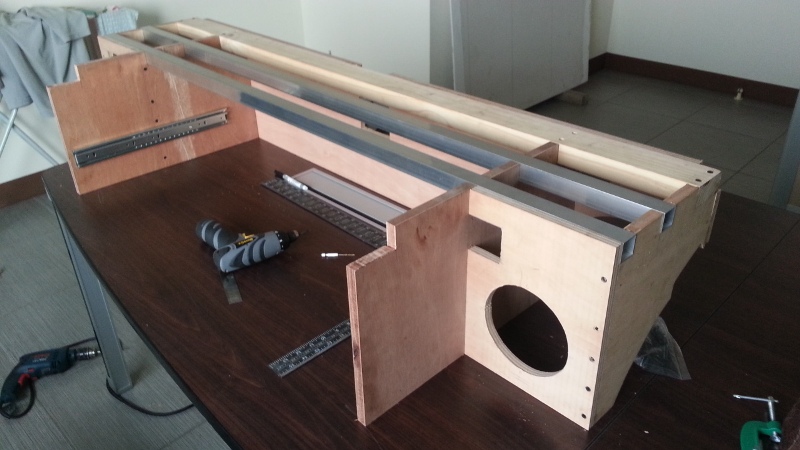

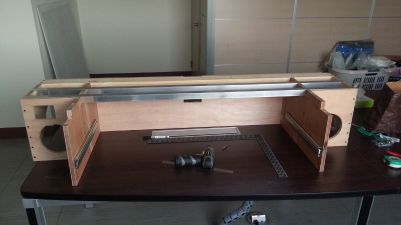

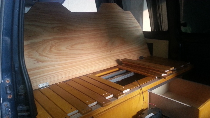

Many woodworking
side1
side1
woodworking1
woodworking1
woodworking2
woodworking2
woodworking3
woodworking3
woodworking4
woodworking4
woodworking5
woodworking5
woodworking6
woodworking6

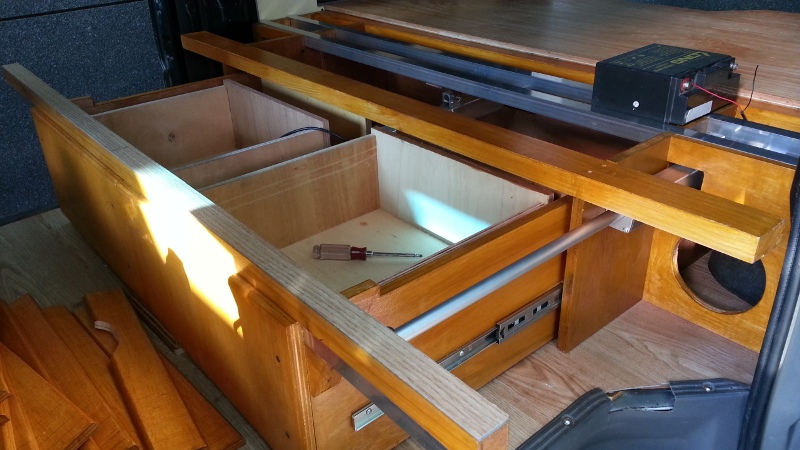

Re: My camping mod
Post by doorgod3 »

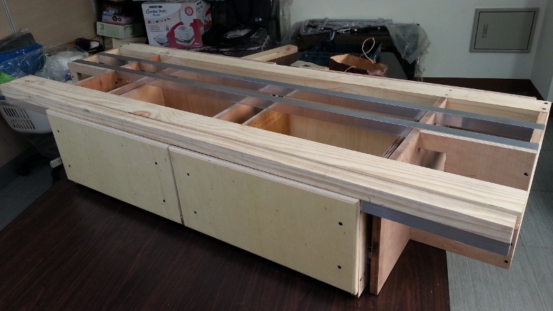

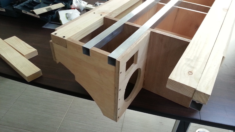

Many many many woodworking :shock: :shock:
woodworking1
woodworking1
Waterproof paint
woodworking2
woodworking2
woodworking3
woodworking3

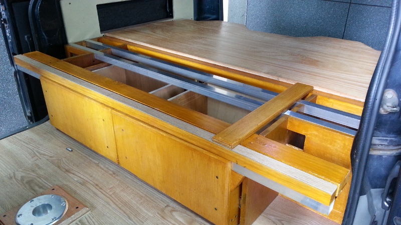

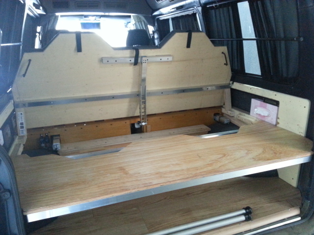

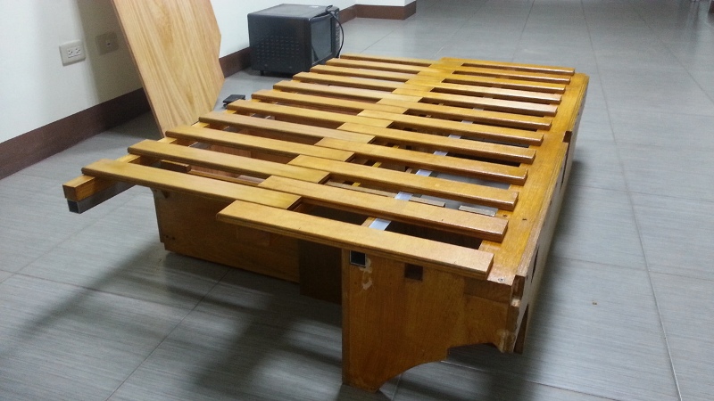

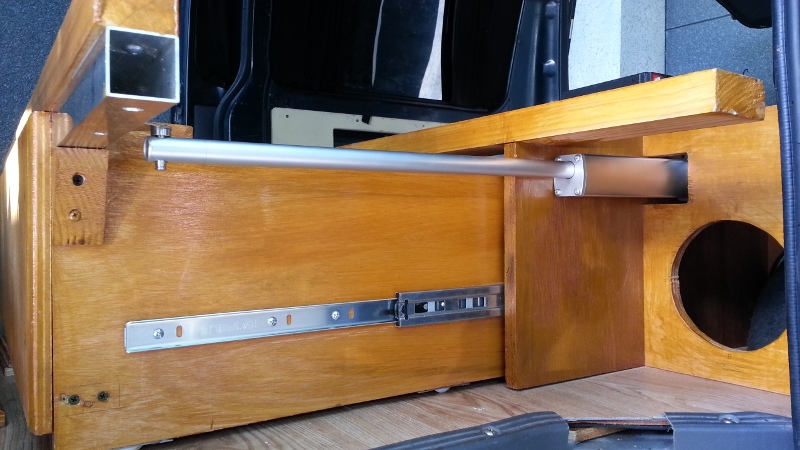

Installation
Installation1
Installation1
Electric actuator
Installation2
Installation2
Installation3
Installation3
Installation4
Installation4

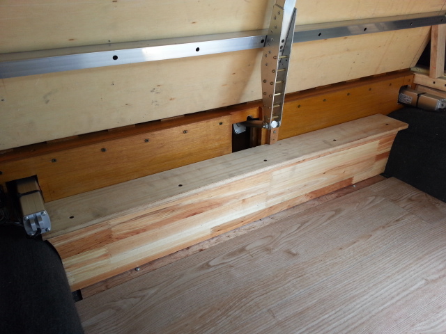

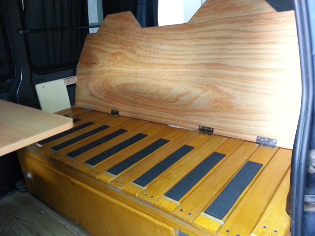

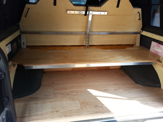

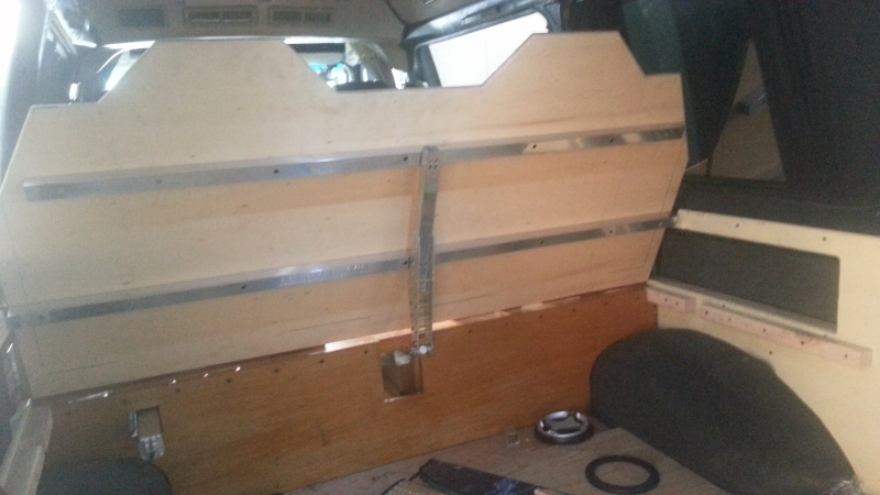

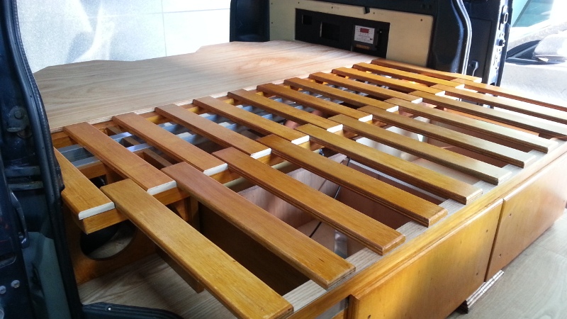

Installation back 8-)
InstallationA
InstallationA
InstallationB
InstallationB
InstallationC
InstallationC
InstallationD
InstallationD
InstallationE
InstallationE
InstallationF
InstallationF
InstallationG
InstallationG

Post by Triumph73 »
That's a great design..... great job!

Post by psilosin »
That's pretty rad.

Post by lrp374 »
I love the electric actuators!! Lots of thought and skill in this layout.
Re: My camping mod
That is a beautiful job, Doorgod, it's a very clever design. How long did it take to conceive the plans?
Cute kid, btw.

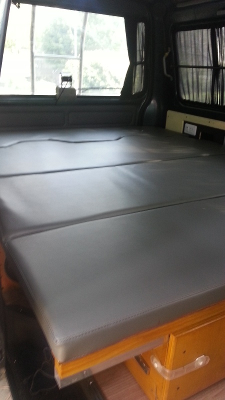

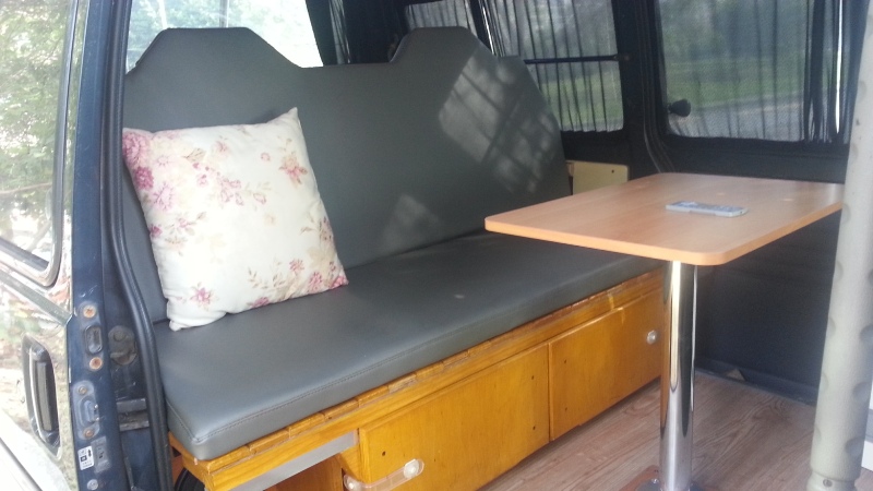

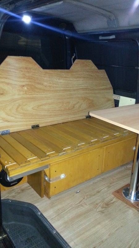

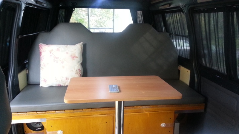

Final
8-) 8-)
Final
Final
Final2
Final2
Final3
Final3
pajerry
Posts: 501
Re: My camping mod
Post by pajerry »
Very cool. I've been envisioning a sliding/folding bed unit for the new truck, and admittedly overkill for what I need, that design is giving me some great ideas!
Thanks for that!

pajerry wrote:Very cool. I've been envisioning a sliding/folding bed unit for the new truck, and admittedly overkill for what I need, that design is giving me some great ideas!
Thanks for that!
Really? Glad to inspire you. everyone's different needs. :-D :-D

FalcoColumbarius wrote:That is a beautiful job, Doorgod, it's a very clever design. How long did it take to conceive the plans?
Cute kid, btw.
I probably spent a year to estimate my own needs.
One month to design and simulation by computer.
One month to prepare tools and materials for woodworking.
One month to do many many woodworking. :-( :-(

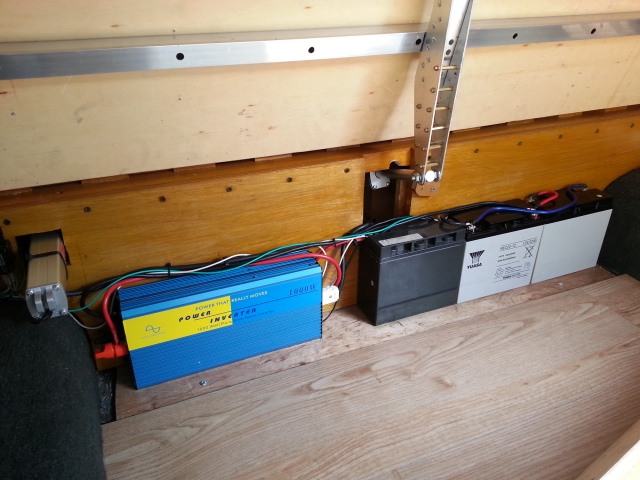

Re: My camping mod
Post by doorgod3 »

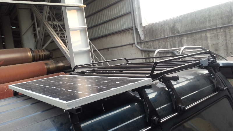

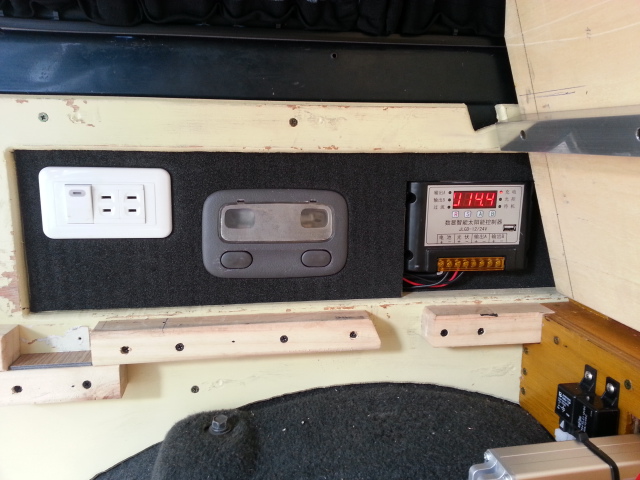

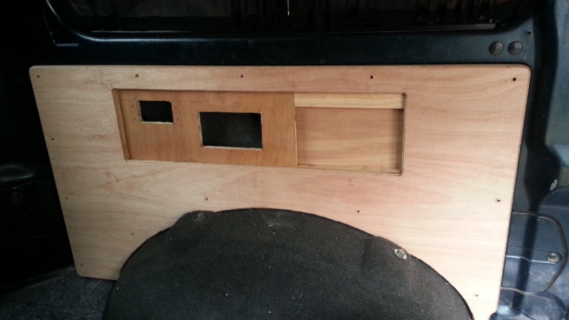

100W monocrystalline solar panels
1000W DC to AC pure sinwave power inverter and 22Ahx3 batteries.
solarcell
solarcell
power inverter
power inverter
cover
cover
charging controller
charging controller
