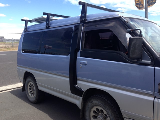

Just completed and installed easily no real tricks to know just have all your tools ready. I placed an 80mm hole in the panel to allowo wriggle room for final alignment and threw out the supplied mounting screws and went up a gauge to stainless self drillers.
The snorkel came from Mark at the Delica shop and was hassle free. A last minute mod was to get the dremmel out and flip the intake grill over so that it was a slicker look. Its still on a dry fit until I throw out the stock air box and replace with a sealed K & N filter (search for their Apollo Filter), paint finish the snorkel black and finish a few other mods in this area.
Definite improvement with out science attached from fuel use, look and sound.
Delica (31) (Small).JPG (60.46 KiB) Viewed 3161 times
Delica (32) (Small).JPG (61.83 KiB) Viewed 3161 times
Delica (33) (Small).JPG (72.34 KiB) Viewed 3161 times
After much reading and indecision I went for the flat version as there is so much debate about whether ram air is or isn't an effect and i can't move my racks because of the awning over the other side it didn't seem to warrant the effort for a traditional snorkel head.
