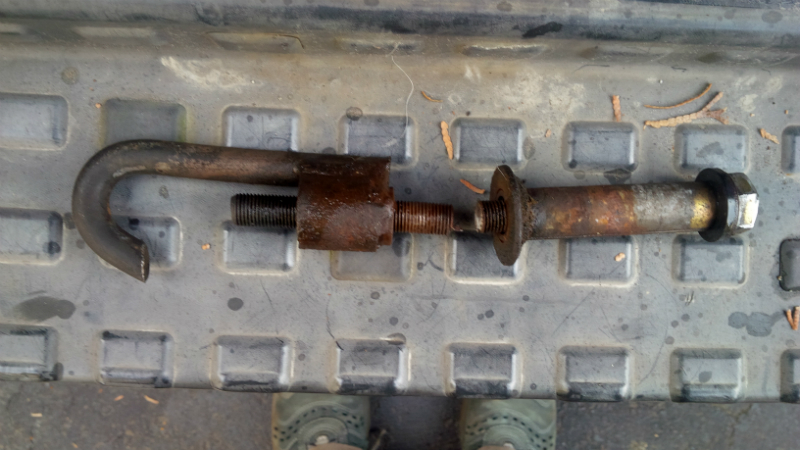

Does anybody have a spare one of these in decent shape?
Mine snapped after removing the spare for inspection.

I havent looked closely at one, but from the pic can you not soak it in penetrating fluid, knock the bolt out and replace it?

yojimbo wrote:I havent looked closely at one, but from the pic can you not soak it in penetrating fluid, knock the bolt out and replace it?
Can I?
I assumed it's one piece.
I'll take a closer look tomorrow.

I have no idea! But from the pic the bolt looks like its dropped through a sleeve. Probably very siezed but doesnt look welded?

it is a drop-in polt, but the part of the thread in the hook is so seized, I'm not sure if I can get it out. Had it soaking in wd for a couple days, may need to weld on a bolt head to move it, maybe heat it up too...
May have to call Mardy or Japanoid or something. Someone must have one from all the junked L300's they have

Can't just go to Fastnel or Acklands and buy a new bolt? If the old one is rusted in put the hook in a vice, heat the part up w/ a torch and turn the bolt out w/ vice grips.

Ended up buying o
A new one from eBay for a few bucks...lol
