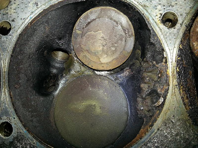

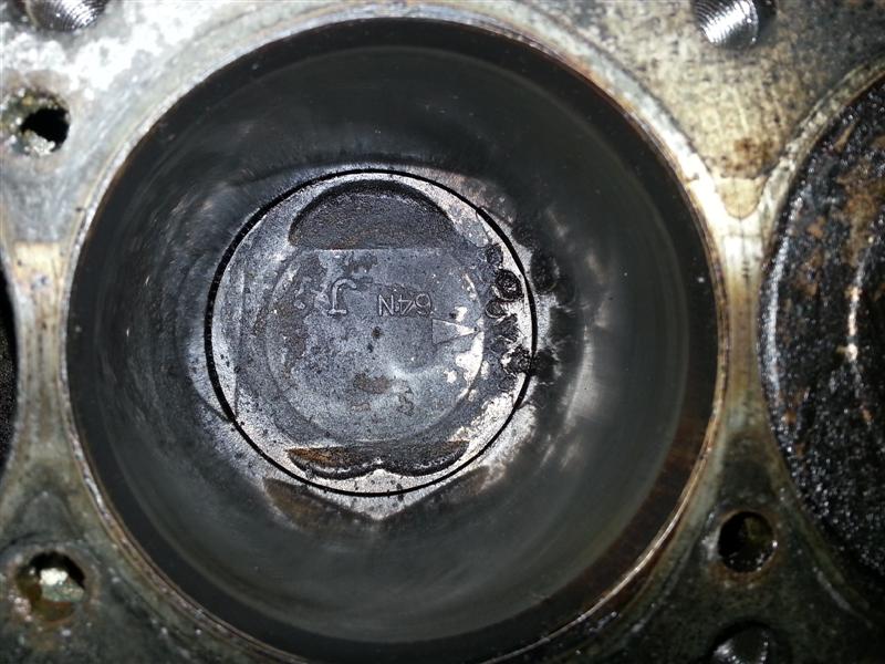

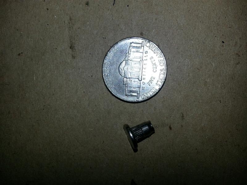

Well I got the engine apart, and it looks like the #2 cylinder has some damage from a defective jet valve. It looks like the bottom part of the jet valve fell/broke off and was in the combustion camber for a while. There is damage to head and the piston. Looks like the broken jet valve piece got pinched between the two a good number of times before being spit out. Also looks like a crack between the intake and exhaust valves,not sure until I get it pressure checked. I was really hoping to avoid replacing the head and the pistons. Also found this piece under the valve cover just sitting in a corner of the head, anyone know what it is?

- Small SS piece found under valve cover in corner of head.

That's the bottom of a threaded stud but I am not sure where on the head or valve cover that would have originated.
The piston might be salvagable provided the high points from the impact are levelled off. If there is any suspected cracks to the piston it might be better to get a new one.
The head is a different story and an engine machine shop should be consulted. They can do a dye penetrant test (because its aluminum) on the head which will show cracks very quickly. A pressure test won't tell you if there are small cracks in the space between the valves or anywhere else for that matter. The impact craters are also a potential source for cracks.

Thanks for the vid, didn't know that was how they checked aluminum cast pieces. I'm assuming the machine shop knows how to check it out. I've been talking to a friend about buying one of his, but it's in North Carolina and on an engine. I'm pretty sure the head is toasted; it looks like there is a small crack between the valves and the craters have really deformed that part of the head. I also took the valve rockers off, and it looks like the head wasn't built properly. there are lots of uneven wear were the cam sits. I've got new pistons coming to me, so those will be new, along with a good number of other parts. It's too bad on some levels, but I'll pretty much have a completely rebuilt engine.
