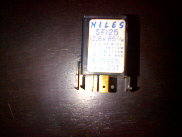

It could be a indicator flasher relay issue,MB338226.
Not combination switch.
Big-Bird's comment is right, cheap & easy fix.
Steven
- L400 indicator relay.jpg (68.96 KiB) Viewed 10306 times

My turn relay was starting to die... got a replacement montero one. Part is a little smaller and doesn't have the clips, but the plugs line up perfectly and it seems to work. Here is the packaging picture
https://imgur.com/tLi9OIC
