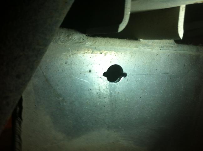

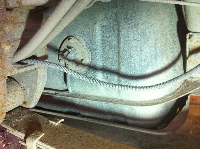

My goal when installing this heater was to leave the van as stock as possible which is one of the reasons I decided that the fuel pickup will be sunk into my extra tank. I also didnt feel like dropping that huge tank so I drilled thru the side.
If I were to put the fuel pickup on the stock tank, I think I'd do it here at what I think is the fuel gauge sender.

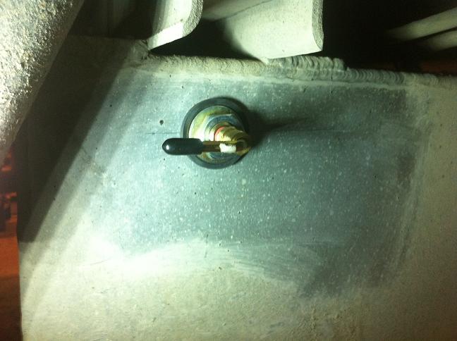

Here's the pickup installed. I bent the fuel pickup (it's a 2ft long brass tube about 1/4 inch thick.. ill put a picture up later) about 30 deg down, near the elbow. It slopes down to near the bottom of the tank.

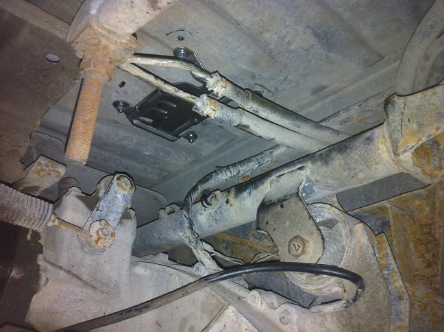

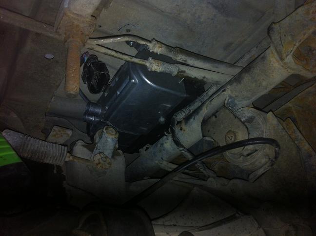

I finally decided on a location for it.. right above the tranny's rear (don't google that). I drilled through the floor and bolted the mount on. Used lock-tight on the treads.
I initially was going to make a box for the heater and not use it's supplied mount. It's mount is more designed for against a frame with the heater vertical, not flat like mine. But there is no room to put it like that, and I didn't have time to fart around making something, so I'm hoping for the best. Once I got it on I gave it a couple of good tugs and it seems very secure.

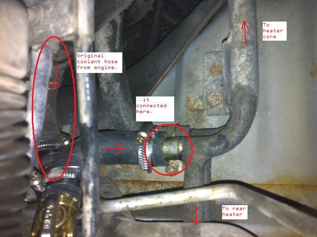

So first I drained the coolant. Then I followed the lines around and figured out how everything flows. The coolant flows from the left hand side of the engine (looking at it from the drivers seat) near the rear. I travels to my picture and splits.. some to the front heater core and some to the rear heater core. Now, there's a few different ways to install the Espar.. I choose to install it in-line for simplicity. Basically, the espar takes the place of the engine for heating the coolant. It also means that I didn't have to cut any of my coolant lines, just disconnect the one as shown. So the one hose labeled Original comes from the engine to a valve that I put in (basic house hold water valve for pex) to espar-supplied hose and onward to the espar. It returns from the espar via supplied hose to another valve of mine (that's the one you see in this pic) and connects back to the original tube.

The reason I put the valves in was just in case I ever have a problem with the espar I can close off both valves, disconnect the hose, then re-connect it in its stock position. One day I plan to clean it all up and just put a 'T' fitting in there with just one valve.. but I think this'll work just fine for now.

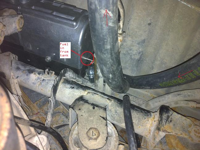

The lines from the valves go to their corresponding ports on the heater. There is an air bleed screw on the far side of the espar that is pretty hard to get to with the way I've installed it. Had to actually drop the espar and slide it forward enough so I could get my hand with a stubby flathead screwdriver behind it. Slightly awkward and kinda crampy. The fuel line from the pickup just gets secured over/around the stock gas tank to the heater. The exhaust line was run down along the engines' exhaust.
The wiring was easy, which was good because I'm pretty retarded with electricity. The harness was well laid out with LOTS of extra wiring. It hooks up to the battery and you don't have to cut into the stock wiring at all if you don't want to. Came with it's own fuse protection as well.
