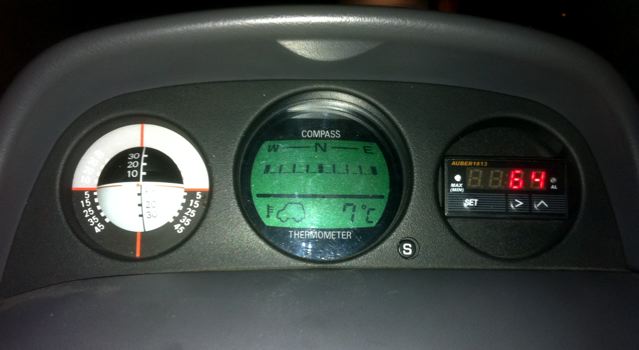

Pretty much all these gauges are Chinese made..
I've run both Glowshift and Auber in two separate Pajero's. The glowshift's are difficult to read with the bulbing face, and the boost gauge does not read properly thanks to altitude. I contacted the dealer about this issue and basically got a "pound sand" in return. They have worked fine for two years now, dealing with very cold winters I've never noticed any real issues, start-up time is quick, accurate measurements. Pretty easy install since you can daisy chain with the factory harness. But I hate how cheap the wiring is! I'm more nervous that a wire will snap just by looking at it!
With Auber, No issues what-so-ever! Wiring was decent, plus you can run whatever you choose on certain applications. Very accurate, easy to read, and you can be creative with mounting positions! But you have to get past the 80's retro look of the gauge itself haha. Also has a better warning system than the Glowshift unit's, which can go unseen.
If I had to choose, Auber everyday, until the looks wore off on me lol.
Pics of both installs.
87' Pajero - Boost/Pyro mounted in center of cluster.
10mm by .:FoRuM56:., on Flickr
91' Pajero - Boost/Pyro/Oil pressure
Blue-Explosioin by .:FoRuM56:., on Flickr
