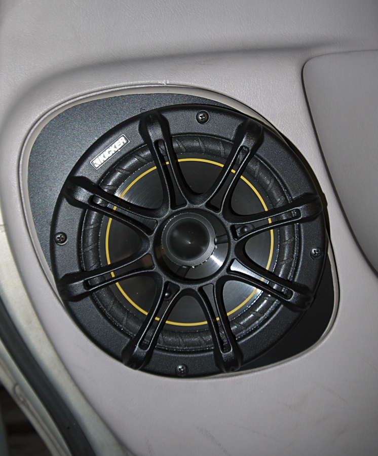

Hi Folks,
Would anyone know if I can remove the grills/mesh without removing the door panels?
Reason being is that I am looking to install speakers on the outside of the speaker mounts rather than under the grills similar to Psilosin (sent him a message but no reply yet). Just want to minimize having to replace or repair door clips/plugs.
Joe

Sorry been so busy smuggling small arms into Syria the last couple weeks I didn't notice your PM... 8-)
Unfortunately yes you have to remove the door panel to get at the screws that hold on the plastic speaker cover + grill (and remove the old speakers). Once you remove the speaker covers the metal grill itself is just pressed/glued into place so just have to get a grip and rip it out. Then if I rememeber I had to cut out much of the honeycomb of plastic from the speaker cover to get it to work as a speaker mount for the kickers. Hope that helps.

Mission accomplished; grills removed.
Wow, didn't realize it would be such a task to remove them from the speaker grills! No flimsy metal here, and heat pressed in as well!
New Kicker speakers mounted and wired in.
Joe
