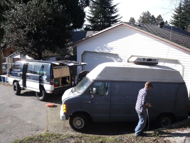

Re: Camperizing the Delishhh.....
the roof is cut down form a dodge van...cut into 1/4s with a skill saw and glassed back together...
http://i349.photobucket.com/albums/q396 ... 1298266225
The older VW roof maybe close...I started with the roof off a 1983 poptop but decided after looking at it I had to 1/4 the roof and reglass it together and then do tent work...I suck at sewing :) and I like the gain of storage with the raised roof...
