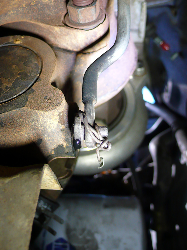

Wow... I am about to reach my limit at this point.
I have another problem. It's just one after another.
I've posted a photo of the bottom part of the turbo. Where the little arm is attached to it. Oil is coming out of there and smoke... What's going on?!?
And my other problem is still the coolant system. I have replaced the thermostat and it was definitely broken. The seal was all shredded. But it is STILL gargling into the overflow canister. Would there be something blocking the inside somewhere?
I am sooooo tired of this s#!t...
- turbo.jpg (431.02 KiB) Viewed 4032 times

Im not sure what can be said.
Must have a crack or something in the casing of the turbo.
If it was just a bit of oil I wouldnt really bother about it but you mentioned
smoke?
I've had my turbo off my old L300 twice, not a fun job but it was a heck of a lot
easier the second time. Redid the intake/exhaust manifold gasket.
In regards to the gurgling, when you put the thermostat back in make sure you
use a gasket or some gasket making goop. You might have some air trapped in
there as well although that really shouldn't be an issue if you refilled it etc.
I would almost be tempted to try some lime/calcium remover made for your
cooling system but that has risks to of releasing buildup and it getting caught elsewhere.
Maybe your radiator is on the blink and full of crap? Build up etc? Flush time?

Your turbo is leaking oil into the exhaust and it's burning off. Turbo rebuild time. If your coolant is leaking into the overflow jug you are either overheating (check the gauge), your cooling system is being overpressurized due to head gasket or head leak, or the rad seal with the rad cap isn't any good.
Your frustration is palpable so time to step back, take a deep breath and clear your mind.
If your temp gauge doesn't show overheating, you need to get the cooling system pressure checked. Easy enough to pick up a cheap pressure gauge at Princess Auto and plug it into the overflow tube. The cap isn't supposed to let go until 13 PSI. If you show less than 13 PSI, the cap is leaking. If it's showing higher levels than 13 PSI your cooling system is being pressurized by the engine. If that happens, then you are into a big repair.
If your gauge shows overheating, raising the temp and pressure to the point where the cap lets go, then it's new rad time. All in all, a fairly straightforward series of diagnostics.

Talked with Coombs and it might be the cylinder head. Smoke is coming out of the rad (cap off) as well. There is a guy in Sundre that import and work on these vehicles. He might want to do some test on it and determine if it is the whole head or just the gasket.
I wonder if replacing the head cylinder is a straight forward job or if it takes some finicky adjustment, which I would not be able to do by myself...

Update on our misfortune;
Turbo is dead. I did found a crack and warp parts last time I openned it. So new turbo will be installed. I brought the van to a guy, Hilltop Cruiser. Check out his website. I think I'm in good hands. He will perform a few test on it tomorrow and determin if it is a gasket, head or cylinder. There is a leak (after presurizing it, but a very small one. He will do it again for every glow plug.
