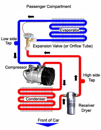

On my Delica there are two condensers and 2 evaporators, one receiver/dryer/strainer, one hi press port,one low pressure port, one hi press switch and one lo pressure switch and finally one compressor. The cooler under the drivers feet (my right hand drive) is actually an automatic transmission cooler. Yours may be different.
Evaporators for cooling inside air are located back and front. Condensers are front of the main radiator and under the pass feet (outside of the van). The receiver/sight glass is found below the pass side evaporator (below 2 ac lines exiting passenger floor at sight glass rubber plug) under the carpet. The low press port is at the compressor and the high port above it on the other (hi press) line (hard to see but feel for it). The expansion valve/ front evaporator/relays are located behind the glove box. The low press switch is located above the forward condenser and the high pressure switch also under the van but at the rear evaporator.
Your vehicle may be different but that is mine in a nutshell. You may visit me in Coquitlam and I'll run you through the operation and test procedures. I have pics of everything but not enough time now to post in the wiki.
IMHO the condenser fan is your problem. Disconnect the power and ground wires to the (main) condenser fan (access from forward and under the van), check for a short to ground and if okay power the fan externally(keep hands clear and turn off the AC). Don't attempt this unless you have a basic understanding of automotive electricity. If it runs the problem is elsewhere.
Sorry to be so long winded. There's more but it's already too complicated. P.M. me if you want pics or more info. Your delica may be different.

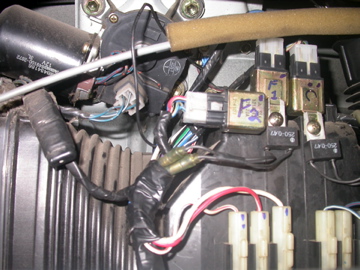

This is the photo I sent to Glen at CCauto to show what I had found in behind the glove box of my deli. I hope its helpful to anyone messing around with their ac control. My van is a 91 exeed low roof with dual zone ac. They should all be similar if not exactly the
same. Below is the system description.
Ok Glen problem solved(Bad relay solenoid ground) on realy F1 (main condencer fan). I have labeled this stuff and thought it might interest you. Right upper relay C with two dots Compressor
Middle upper relay F1 with one dot main condenser fan
Lower left relay F2 with one dot secondry condenser fan(under passenger footwell)
Fuses Left side two dots compressor
Next to left one dot secondary condenser fan
Third from left one dot main condenser fan
Loose black wire is rerouted relay ground.
Feed wire from realys to fans both solid blue looked like 12gage
Out put temp dropped from 64 f to 52 f when main fan kicked in. Thanks for the info hope you find this helpfull.
Andy Wilson
Sayulita Mexico
Andy Wilson
