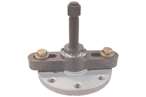

Be carefull not to tap too hard on the outer drums cast shell, its not built for impacts, and will chip/crack if provoked. Make sure your E-Brake is off. If the drum is heavily worn, you will not be able to pull the drum shell off easily and will have to use the threaded holes for extraction. (do this anyway if you cant wiggle the drum off by pulling hand...dont count on it coming off readily)
The delica drums are the same as most rear drum assembly from the same period, so google away to see how to use the threaded removal tool...
- This is very similar to the one I used
- 10851automotiveyokepullerforflangestyleyokes_10100547.jpg (20.13 KiB) Viewed 5305 times
