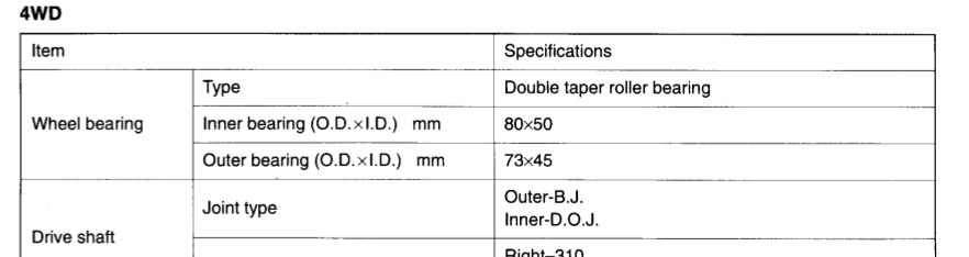

I need to replace the front right wheel bearing on my L400 (bearings as I gather there is an inner and outer bearing on the front wheels).
I tracked down the bearing size in the shop manual available on the Delica.ca site, but unless I missed out there is no part number specified (see the image below).
I have also not managed to track down part numbers for these bearings that anybody has mentioned in a post to delica.ca, although I am guessing somebody has already.
Can anybody point me in the right direction for part numbers for these two bearings and the associated seal?

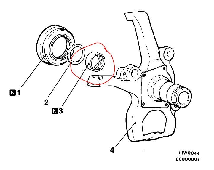

There's a 3rd bearing in that area. Its a small roller type that supports the outer stub on the CV axle inside the spindle. These can get gummed up with grit when the inner seal fails.
They can cause vibration problems as well and often get overlooked when a person repacks or even replaces the bearings for the rotor hub because the CV axle does not always get removed in a repack job.

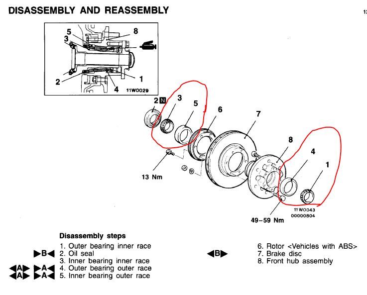

Can you explain further where this 3rd bearing is? I only see two on the assembly explosion:
dakeddie
Posts: 3
Joined: Mon Nov 19, 2012 8:24 pm
Vehicle: 1994 Delica L400
Re: L400 Bearing specifications?
Post by dakeddie »
Found it. It's in the front knuckle.
