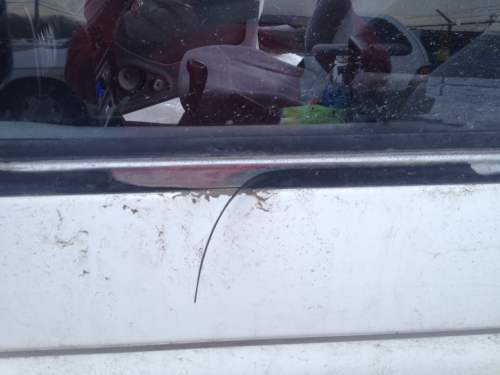

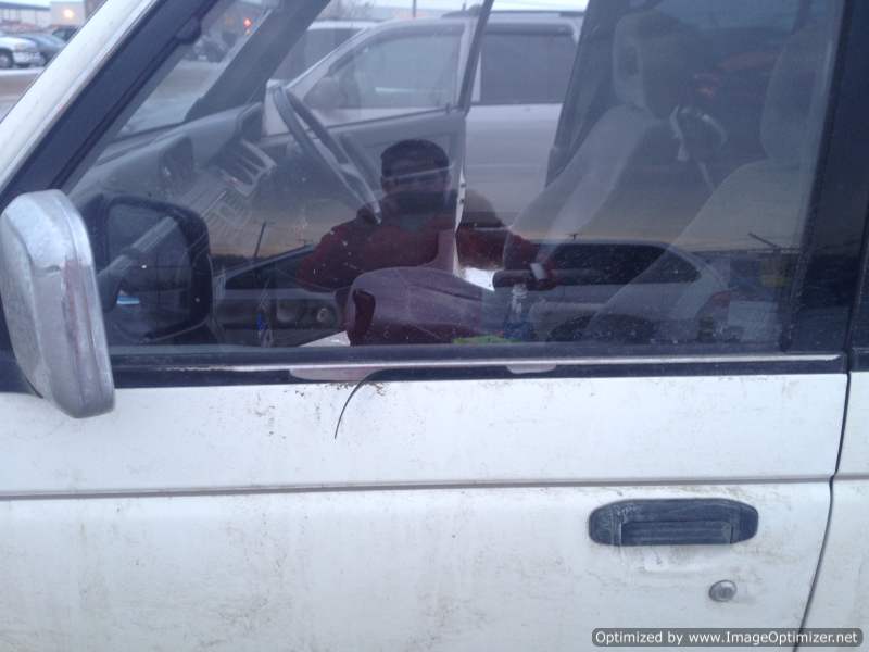

Hi all,
1994 LWB 2.8 5spd Paj. This trim had been cracking ever since I bought the machine - last July - and just the other day when pulling snow off the car it finally gave way. Any advice on how to fix/replace? The metal underneath is bare and is starting to develop small surface rust.
photo 2-Optimized.jpg (36.88 KiB) Viewed 3702 times
photo 1-Optimized.jpg (17.22 KiB) Viewed 3702 times

I'd take it off, clean it and plasti dip it. Any color you want.
Worked for me for some care parts.

There is black adhesive 2in trim tape that you can use to replace, just remove the original, replace and use a straight edge and exacto knife to fit in place. Can tire is where I got the tape, worked well. :-D
